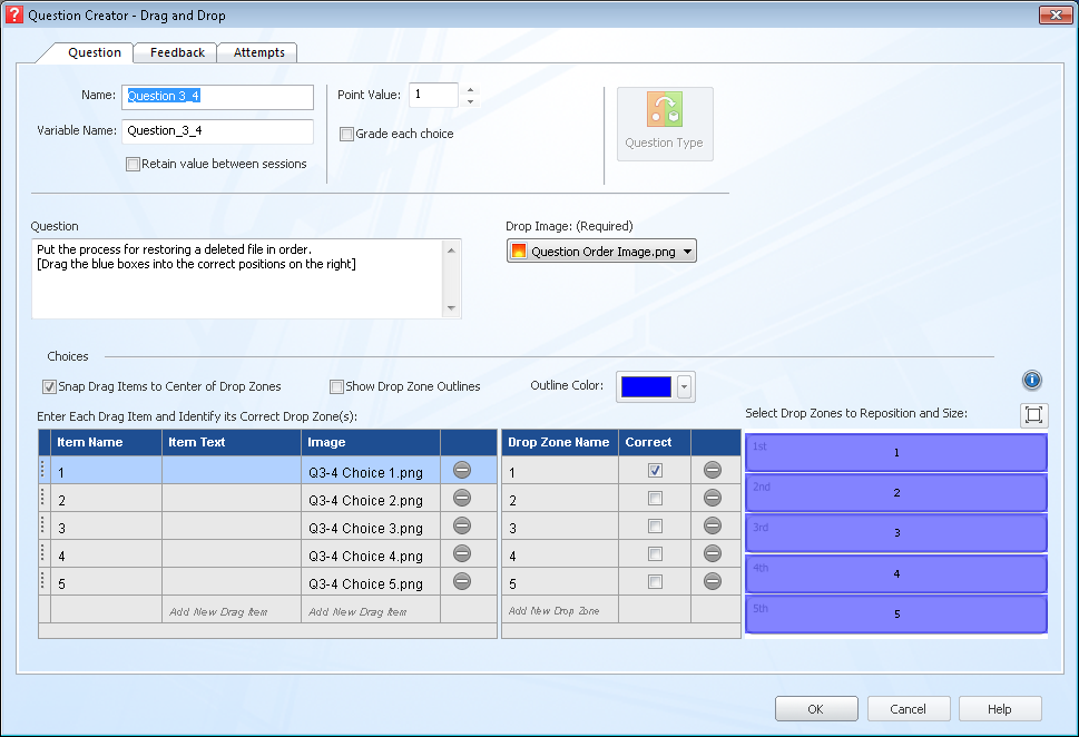

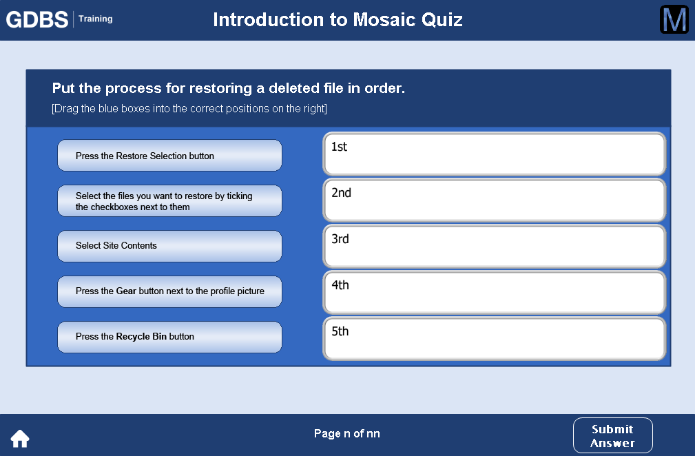

The drag and Drop question has images. Unfortunately I can't share the course content, but let me try to add a few screenshots.
In the section that's only scoring 75% there is one Multiple Choice question, 1 hotspot question and 2 drag and drop questions.

I don't have them in every question - just the Drag and Drop and Matching style questions. I've removed them from the question text and added them in using a separate text box, and I'm now scoring 100%, so that must have been it.
