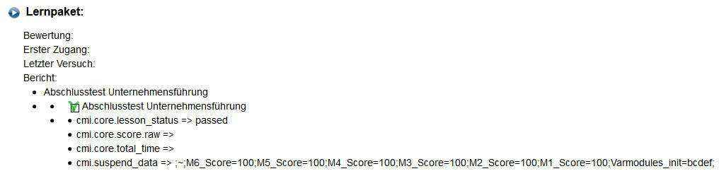

Which version of Scorm do you use? I don't know too much about later versions but Scorm 1.2 allows only one total score (AICC_Score). It should be possible to use "cmi.suspend_data" to store test section scores or test scores but the LMS won't recognize these as scores, only as variable values. It's still better to use 3 tests instead of one test with 3 sections because the variable names are much shorter and the space in "cmi.suspend_data" is rare.
I attached a screenshot from moodle 3.0 showing the report for an AU that contains 6 separate tests. None of these scores directly influences the total score for the AU, but as test scores are by default "retained between sessions" they are all saved in cmi.suspend_data. (Most is in German but the last bullet point shows the suspend_data with all separate test scores.)
