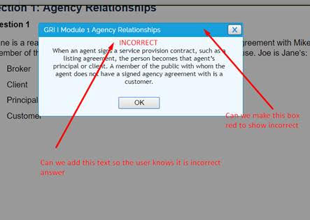

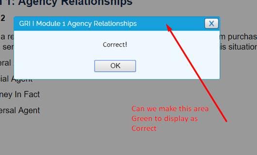

Hi there! I'm looking to style the question feedback "Display message" according to the screenshot(s) here. I can't seem to locate that option in Lectora Online. Anyone have any luck doing this?

The short answer is No.
The long answer is Yes, but you're limited. You can adjust the window by changing the code (trivantis-dialog.js I believe) provided within your Lectora output. The changes we recommend are minimal and don't match what you described. Doing any more could cause some serious issues with your course.
Better than using the default option is to create a customized pop-up window! These allow for style changes and additional content to be displayed, as well as, being able to adjust the background, size, and location. It's just a page put at the end of your course that you customize the look and feel of. Then when selecting your feedback options you choose to go to that page but in a new window. Additional window properties which are updatable are available from there.

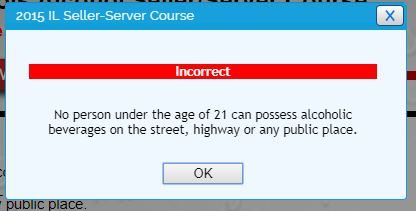

If you really want to use the Display Message popup you can also enter HTML in the Message, for example I use this as one of my incorrect messages:
undefinedNo person under the age of 21 can possess alcoholic beverages on the street, highway or any public place.
See the attached image for how this looks.
You need to publish with Use Lightbox Popups enabled for HTML to work in Display Message. If you are doing an accessible title and cannot use Lightbox popups then you could maybe do some simple unicode formatting as described here: https://stackoverflow.com/questions/5278197/html-tags-in-javascript-alert-method
