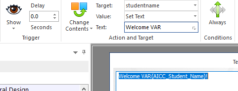

I have been changing the content of a textbox with the VAR(AICC_Student_Name), it works but the Firstname is duplicated. I have checked our LMS, but I have only one name in there.

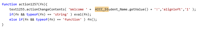

I run the course from our LMS, and inspect the elements and I've got attached screenshot.

You're using JavaScript to read the student name. I always used the built-in variables in Lectora, in Lectora Actions.
I believe that to access a Lectora Variable within a JavaScript extension, you would preface the variable name with "Var". Try using "VarAICCStudentName".

Yes, I have used the built-in variable from Lectora. The above screenshot was when I run the course from LMS and inspect the page element.
But in Lectora, I have an On page Show action that will change the content of the textbox with a text + variable.
