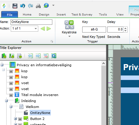

Sorry it's a Keystroke action only available on a page, click into the next key typed trigger and then hold the alt key before pressing the Q key...
I see in Lectora Desktop you can't do this, I'll write up a bug on this. It works in Lectora Online.
How do you use an On Key Lectora action to be triggered on Alt + Q? I can select one key only, Alt is not accepted.

We went back and tested this and an On Key triggered action for Alt+Q is working for us with publish to seamless play enabled. Please post an example title or let us know the specifics of what your publish type and options are, and how you are delivering the course and what browser you are using. This should work so we are very interested to see why it is not! Thank you for reporting it ....
Yeah it took me a while to figure it out, anything more than Ctrl+C and Ctrl+V is a struggle for me! Heh heh.
... but thanks for the explanations how to press two keys at once, might be helpful from time to time ;-)

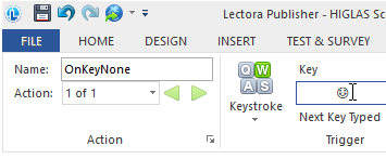

I'm trying to use a keystroke combination with an Alt+O, but am having no luck. I've tried both seamless and not, but whenever I place my cursor in the field for the trigger and then press Alt it doesn't work. I get what is shown in the attached image file.
Oddly enough, when I try another combination Alt+A, I get different results (see second image) ==> a smiley face?
Both actions were placed at the page level.
This is Lectora PUBLISHER v18.0.2 — we had to buy the stripped down version of the software to pass corporate security requirements.
lectora-keypress-Alt-2019-05-22_14-21-51.pnglectora-keypress-AltA-problem-2019-05-22_14-27-05.png
@Maura T. Sullivan, Joe Wieloch of Trivantis posted above that this did not work (last Summer) in the desktop version of Lectora. One wonders if they ever got around to adding it.
