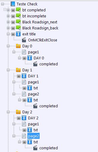

The problem I'm facing is to set the lesson_status for each AU that I have in the course. Using lectora 18 and Moodle 3.2
As you can see in the video, at some point it "locks" on a specific au and change the status juts for this specific AU.
in the picture you can see the strucutre in lectora, day 3 does not show but is identical to day 2.
day 0 has 1 page, the other days have 2 pages where the lesson_status is set to complete on the second page.
if I go to the day 1 it sets to incomplete, then going to the last page it set day 1 to complete with the green check, BUT when going to day 2 or 3 and trying to set it to complete it changes day 1 status, no matter if I'm in day 2, 3 or 0.

forgot to post the strucutre picture, it's attached
