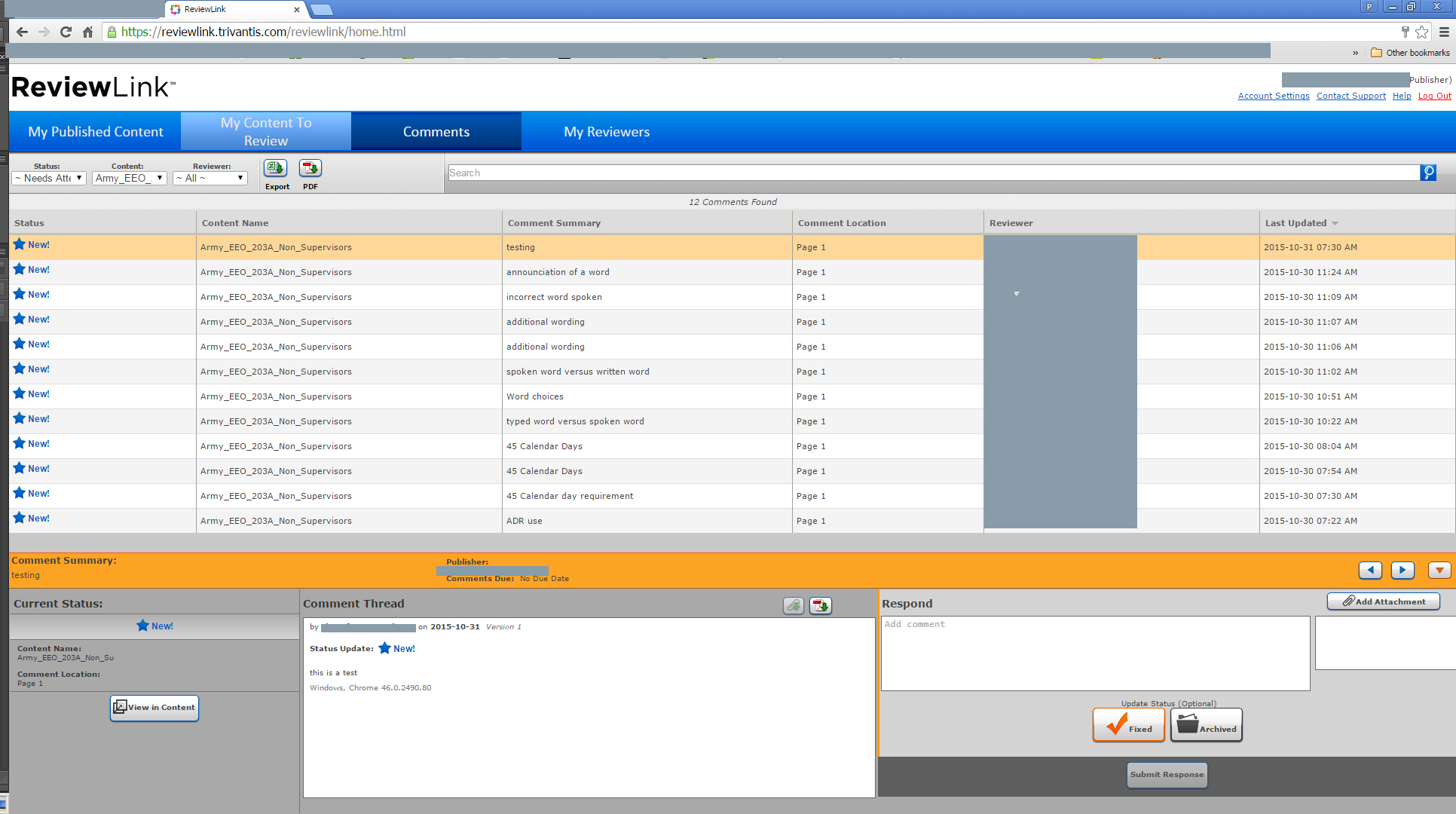

I'm having the same issue and even tested it out myself. Regardless of the page I'm on, the comment shows that it was posted on page 1. This is a big issue..... I have a VERY important course under review by Sectary of the Army EEO and their comments all show on page one. Depending on what they state, I might not be able to find where the problem was.

My faux pas, my issue was with Lectora publishing into Reviewlink not storyline. Interestingly enough though it created a similar situation on it face. After working with Tech support and sending them my course file we identified the issue that was causing Reviewlink to make all pages as page 1.

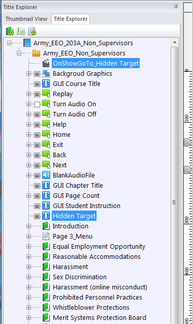

For some background, my developer was following the idea in this video (about 5 min mark) to help with 508 compliancy & screen readers. for the record we utilize JAWS. I liked this method but did not care for the fact that user would have to essentially click the next button to proceed then click the invis button to skip the reading of the nav buttons. This meant that the user would have to double click each page. A 50 page course would require 100 clicks, twice the amount of a normal person. To get around that, we changed the button to an action when the screen loads to auto skip the navigation buttons using "OnShowGoTo_Hidden Target". This refocuses the page past the navigation buttons. This works fine (internally tested) but apparently does not work well with ReviewLink.
Tech Support suggested to move the action from title level to each page. Which I'm sure would probably would work but seems counter productive to make a call that we now have to replicate on every page.

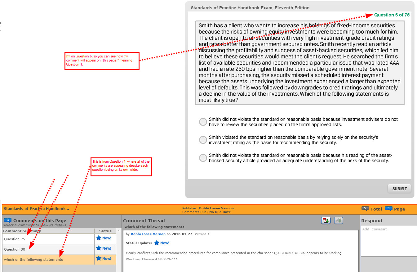

It appears ReviewLink does not work with Storyline question banks. All comments are associated with the first question. See screenshot.

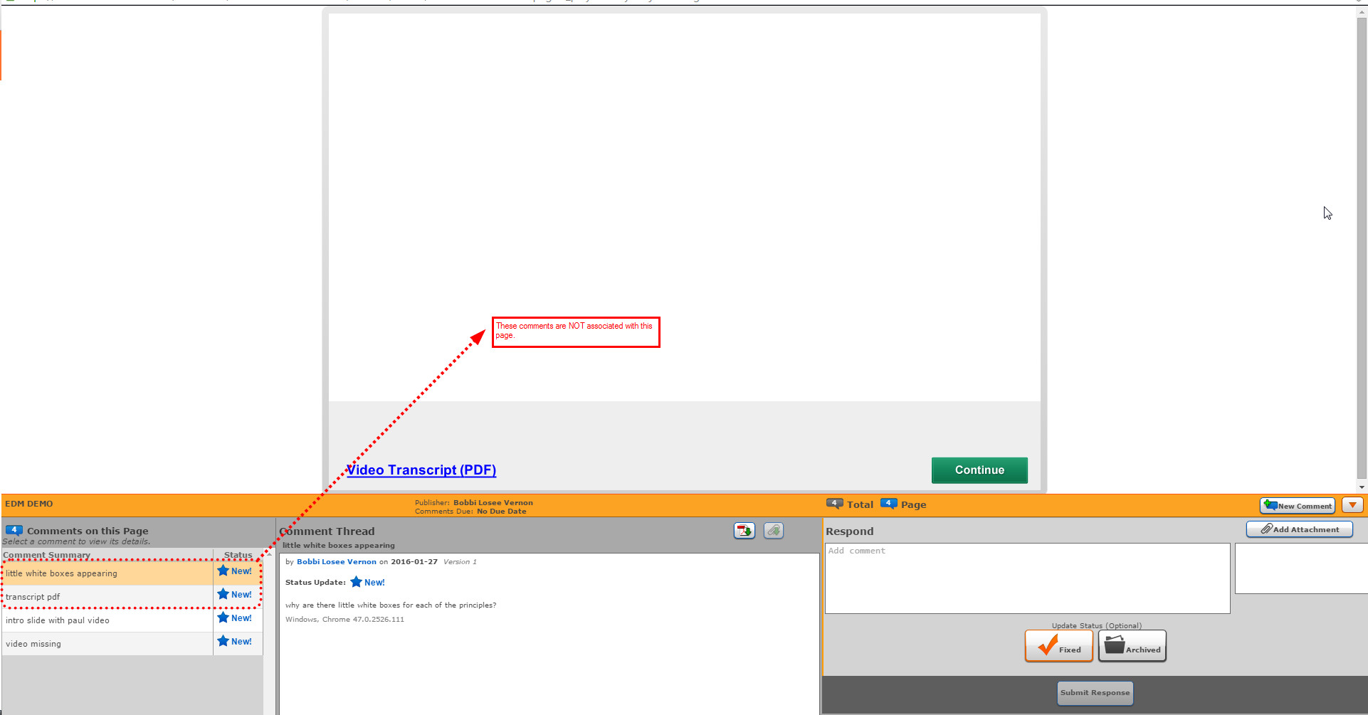

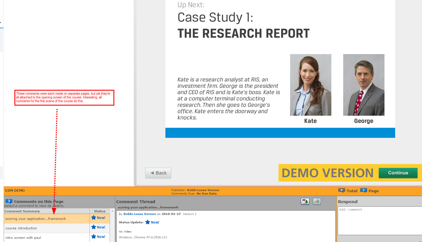

And, finally, it appears the comments for Storyline courses are still associated with one screen in the course. That said, I've provided more information in the screen shots. A summary:
  • All comments for the slides in the first scene are attached to the first slide.

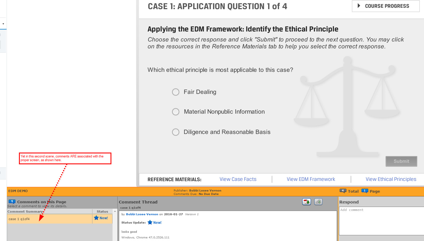

  • The comments reset when I progress into the second scene.
  • Comments in the second scene are associating with the correct slide.
So I'm at a loss as to the inconsistent behavior.
Is anyone else still experiencing this?
