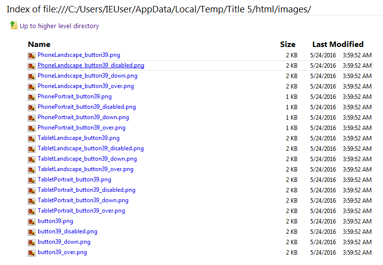

The attached screenshot shows how many images are generated for a single text button in an RCD title. WOW, I did not know that. Out of curiosity, I went to check how many images are generated for LUC2016 app that I built. The answer is ZERO. I used textboxes with OnClick actions instead of buttons. I think this would be a viable workaround for Elena and others.

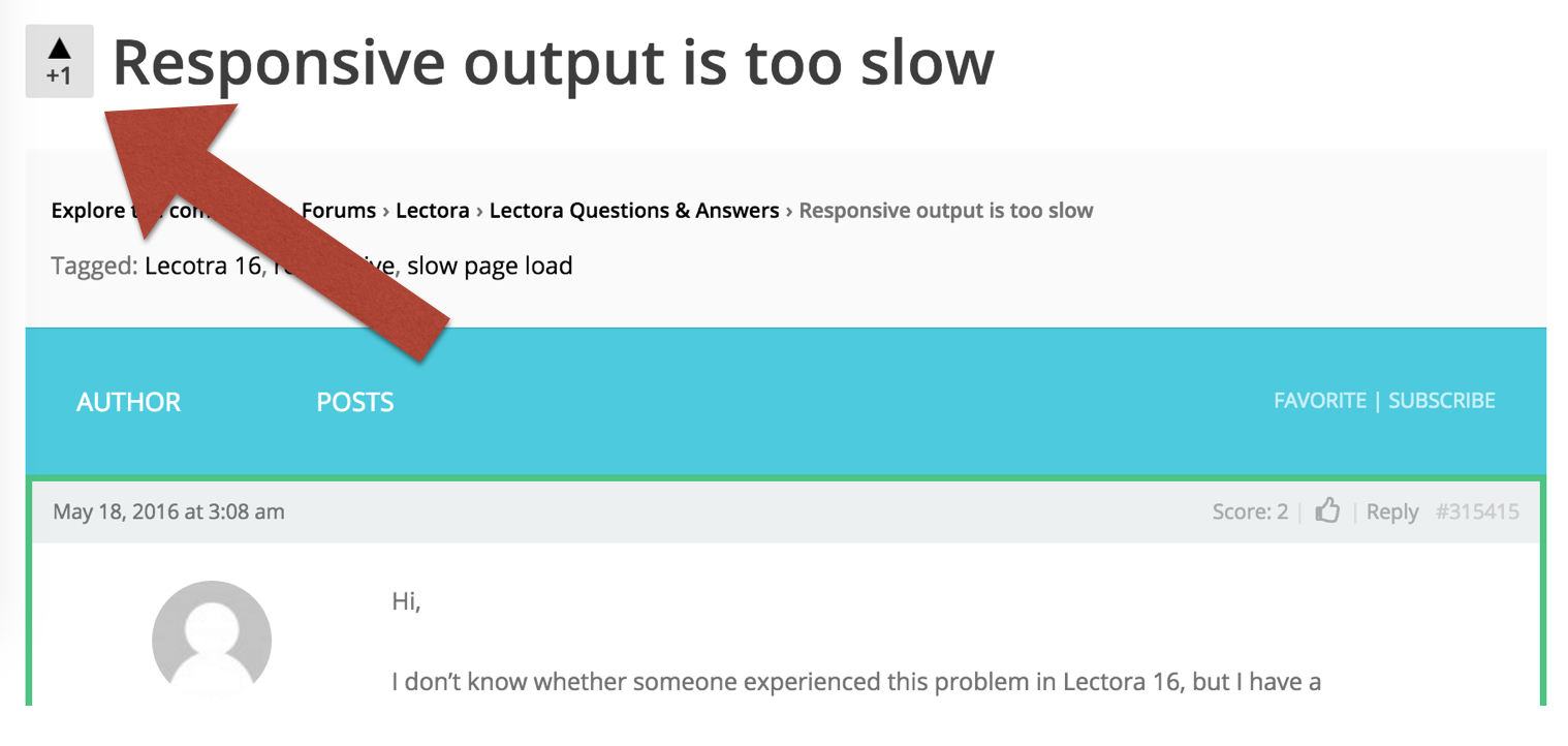

Peter, see attached.
Sergey, got it now, thank you very much.
Peter, I think you are supposed to upvote posts by the means of the "up arrow" next to it. The thumbs up icon is for selecting best answers.
