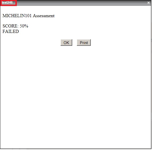

I forgot to mention that I'm using Lectora Enterprise for the test result page. I've unchecked the Customized Test Result option. Hence, the system generates a simple pop up window showing scores and status only. I'm attaching the screenshot for you guys to understand this better. I''ve indicated the pop up title showing "test246" in red box. How can I change that and minimize the size of the window?
Sorry if my earlier question was confusing.
I just tested with Lectora 12 and if you "Use Lightbox Pop-Ups" the title of the window will indeed be that internal identifier for the test.
You can change it by adding a "Run Javascript" -action to your Done-Button (or where applicable):
var mytitle = undefined200pxundefined)[0].innerHTML = mytitle;
document.getElementById("DLG_Div_TR1undefinedDLG_content_TR1undefined
Enter your title in the first line between the quotes, enter the height you want it to have in the second line.
