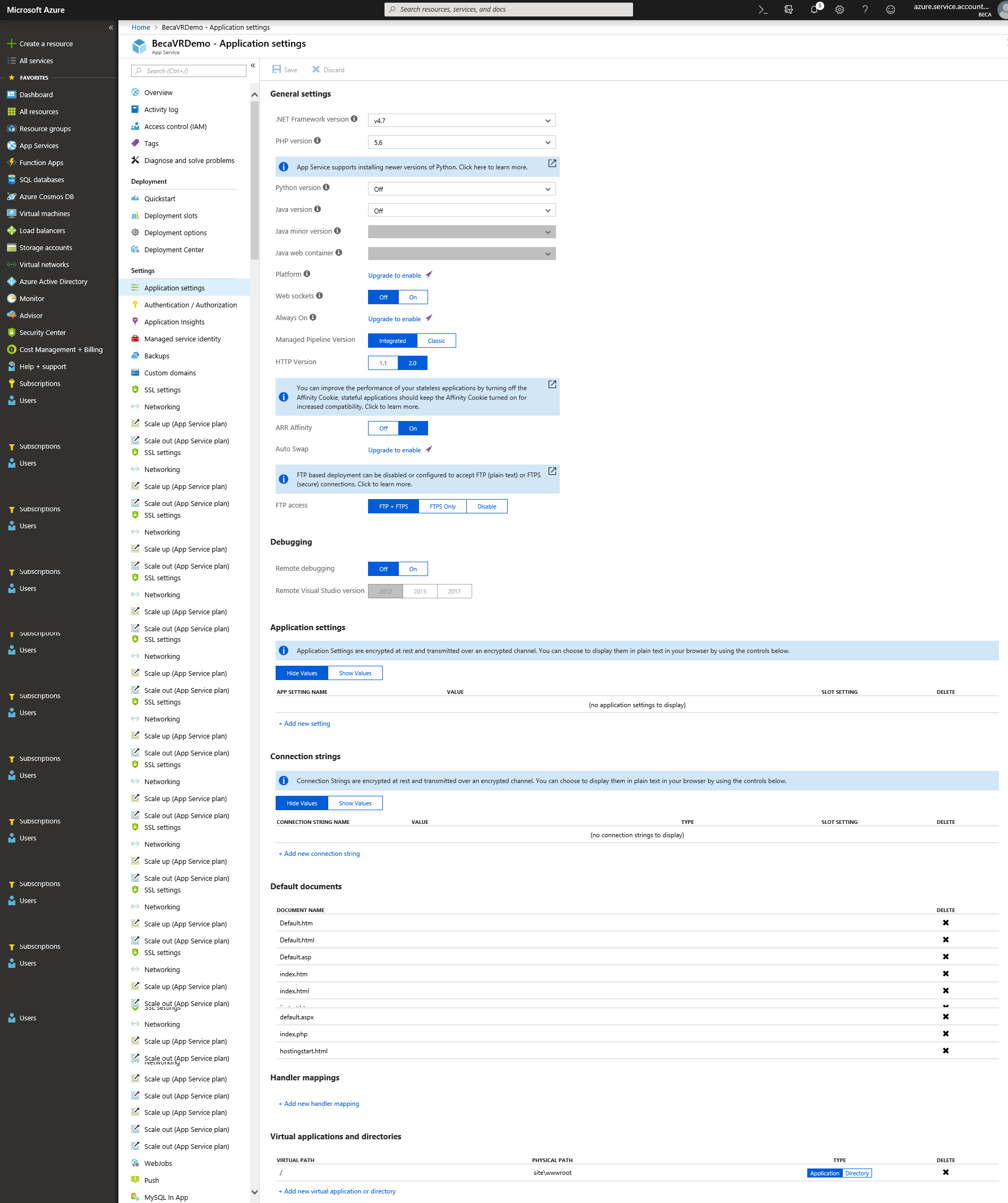

So my tech guys are having problems running this in a website and have asked me to ask a few more questions. they are looking to host in Azure and are trying with the azure web app.
they get the same error parsing from server message that i got when trying to open locally. so does this mean we are doing things wrong?
I have included their screenshot of the settings
Just wanted to post the answer here as we got this worked out offline. The issue was that the Web server was not allowing .JSON file types to be served to the browser, so the scenario was missing some files when it tried to run. Adjusting the server settings so that it served the .JSON file allowed it to work.
