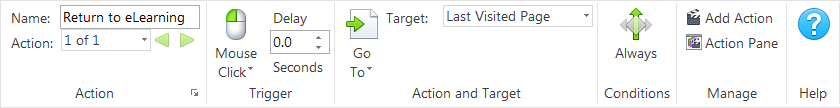

In my course I have a Help page that used to open in a separate window, but that's been causing problems for our mobile users, so I'm converting it to go to the page, then return to the last viewed page, but it doesn't seem to be working.

I don't have it set to Previous page - I have it set to "Last Visited Page". I'm using Lectora Inspire v16.2. Screenshot attached of the action on the shape, but nothing happens when I click it.
Previous page sends the user to the previous page, relative to the current location. So if it's the only page within it's chapter it may not recognize where it should go. Try switching it out with Previously Visited Page. That one will take the user to the previously visited page, regardless of its location within the title.

I'm on v16.2 Tim. I can't understand why it's not working either. Like I said - I have another Lectora Course where I've done exactly the same thing and it works. It's like once it gets to the Help page, Lectora can't remember where it's come from. The Help Page is the only page in the Help Chapter. I can go to it from any other Chapter in my course , but it won't g back. Here's the action on the Help button:
