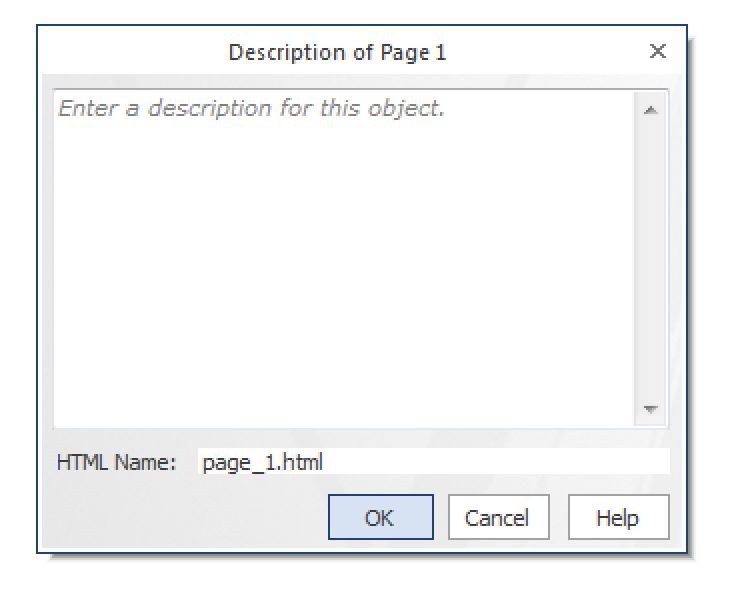

No, only with mouse. Tabbing skips the field with the name.
How can I get the HTML Name via keyboard?
Whoops, nevermind, I see you updated your post.
Ok, but the id of the page is always "pageDIV"...
Can you select the html name with the keyboard again in 16.2.2?
