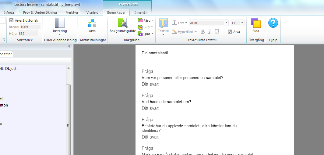

Another question about customized test results:
Can you advise me on how to make the "inherit page size work"?
As you can see in the attached picture (even though the text is in swedish), the size of the test results is not 1009 wide, like it should be according to the settings. Any help with this is appreciated.

Yay, glad I could help. Also, hello from Latvia :)
Regarding the customized results page size. I did a quick testing and here's what I found:
1. To change the page size, set it to the desired value (e.g. 777 px x 1000 px), then ADD a question to the test or REMOVE a question from the test. Adding/removing a question forces the customized results page to refresh and sets it to your desired dimensions. Simply typing the numbers doesn't do anything, unlike normal pages.
2. You have to do the same (add/remove questions) to refresh the customized results page to take into account new question content. It seems like the size of the customized results page is semi-automatic, so you have some control over it while it tries to adjust to the size and quantity of your questions/answers.
3. Important! If you set the page size to "inherited" and follow the above procedure to reset the page size, Lectora will crash. I think it is a bug (what do you think, @johnb?) but the workaround is super easy, just set the dimensions directly as explained above.
4. The Ok & Print button positions are set to "offset from right", so keep that in mind when adjusting them and make sure they are in the correct spot after you've done editing all questions.
Hope this helps.

Many, many thanks! And I can confirm number 3 - now I understand why my course crashes all the time. Hope to see an update/fix for this soon :-)
