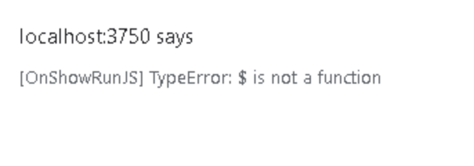

OK thanks for your messages, so i have added an action to a submit button in lectora.
"Run JavaScript" and added the following:
Varname.getValue(this.value);
Var_slider1.set(this.value)
I get an error message after pressing the submit button "[OnMClkRunJS] ReferenceError: Varname is not defined"

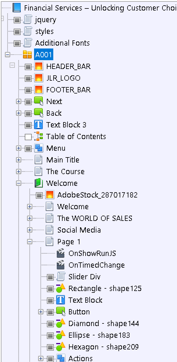

The sample requires jQuery. It should work when you also copy the HTML extensions on title level "jquery" and "css".
It works fine on its own. copy page and add assets and i get error, see attached

Please see attached
When you publish to Scorm nothing should be on title level. Try to move it to AU Level, i.e. where "HEADER_BAR" is. You could also move it to the page, if you don't need it for the whole course.
I had already done that please see attached.
