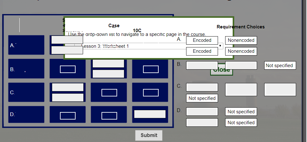

I have a drag-and-drop interaction. I'm trying to ensure that I layer a few template based items (Contents, Glossary, etc.) above the dnd choices. I'm running an action group that shows the Table of Contents. It isn't assigned a class, so I can't getElementsByClassName. That's fine, I'm using getElementById. I would like to use an html extension to update the css to set the zIndex for a few items like the TOC to always be at a higher level. Does anyone know if Lectora searches for the highest zIndex to set the dnd choices, or if I try this will it work? If it won't work... how do I ensure that my TOC (and related objects) are indeed the highest zIndex so that they appear on top?

I tested successfully to bring a shape on title level over a dnd question on a page in Lectora 17.1. Have you checked whether the question is "always on top" as well?
TimK, I have tried just using the "always on top" however, none of the TOC elements actually wind up on top. Give me a bit to look at it again. It currently looks like this.... you can see that the choices are layered on top... and the TOC group is layered below.
So, I came up with an answer to this... I used both
$("div[id*='dropzone']").hide()
items[i].style.visibility = "hidden"; (with Tim's loop). I didn't care if they stayed visible or not.
