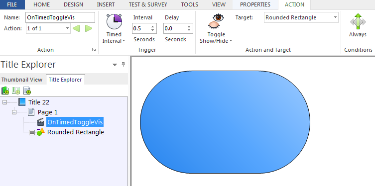

What do you mean by blink? A quick an easy solution would be to put a timed action on the page. On: Timed Interval, Action: Toggle Show/Hide, Target: (Object). The action will repeatedly fire, showing and hiding the object, giving the illusion of blinking or flashing.
Clammers solution is simple and effective.
Hi Jill. As Clammers suggests you place the object on the page and then insert an action on the page itself. The trigger will be Timed Interval. In the Action and Target section select the action Toggle Show/Hide. The target you select in the drop down will be the object you want to blink or flash. You then adjust the Interval and Delay in the Trigger Section to your liking.
You can see the complete setup in the screenshot below.
