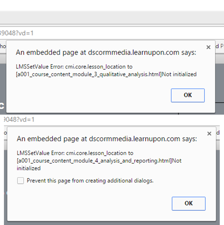

Hi: I have an error with the course in Chrome not Internet Explorer. The audio does not work in Chrome.
I double checked my mod variable settings (screenshot):
On: Show
Action: Modify Variable
Target: AICC_Lesson_Status
Value: completed
The LMSValue Error indicates embedded media (audio I assume) is not working.
What can I do if all the settings are correct and it works in Internet Explorer and not Chrome.
It's urgent.
Thank you.
The error refers to cmi.core.lesson_location. This variable contains the bookmark. I can't find a reference to media / audio files? The error says "embedded page" which should be the course page (embedded in a frame provided by the LMS). "Not intialized" means the course tries to set the bookmark before the connection to the LMS was established.
Sorry, I'm not sure how to solve it. If you deactivate the bookmarking feature, it should be solved, but in case you need it... I'd usually advise my learner to close and reopen the training.
Mascot, the SCORM API requires that a call LMSInitialize first be sent to the LMS. This prepares the LMS to receive and accept communications. The cmi.core.lesson_location is the data element that is used to bookmark the students location in the lesson. I believe, from your attachment which in part says "Not Initialized", that the error indicates that the lesson_location call was sent before the LMS received the LMSInitialize call (or it failed).
