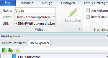

one question about a strange (and frustating) thing in Lectora (Inspire 12). I'm using a streamed videolink on a page: entered the object, filled in the link to the video (mp4, stored on an internal kaltura server), tested the page in browser - looks good; everything is fine.
I worked on a while in the file, published the project and then the strange things happens. Some of the links to my videos changed from "https://media2.de/a.mp4" to "#2B6AF#https://media2.de/a.mp4" which causes that the video cannot be loaded.
I can change the links back to the original ones, but after a while this happens again. Not only when publishing and not the always the same videos. I cannot figure out any regularity.

And yes - I have some blue in my video :) But as you can see in the example file the links are changed on different ways; in the file you can find #9f# instead of #2B6AF#.
But one thing I already figured out: It seems that this is only happening when I add an action to the video - I want to go to the next slide when the video ends. On the videos without this action nothing happens.

Because it is hard to believe that this is happening I have recorded my screen and I will try to add this short capture (<1 min, recorded in real time).
The project you can see is a blank project started from scratch with only two videos and just one textbox in it.
Maybe this have something to do with the custom controller skin? I have copied an existing skin and only modified some of the image files. I will also add this to the post.
