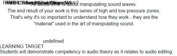

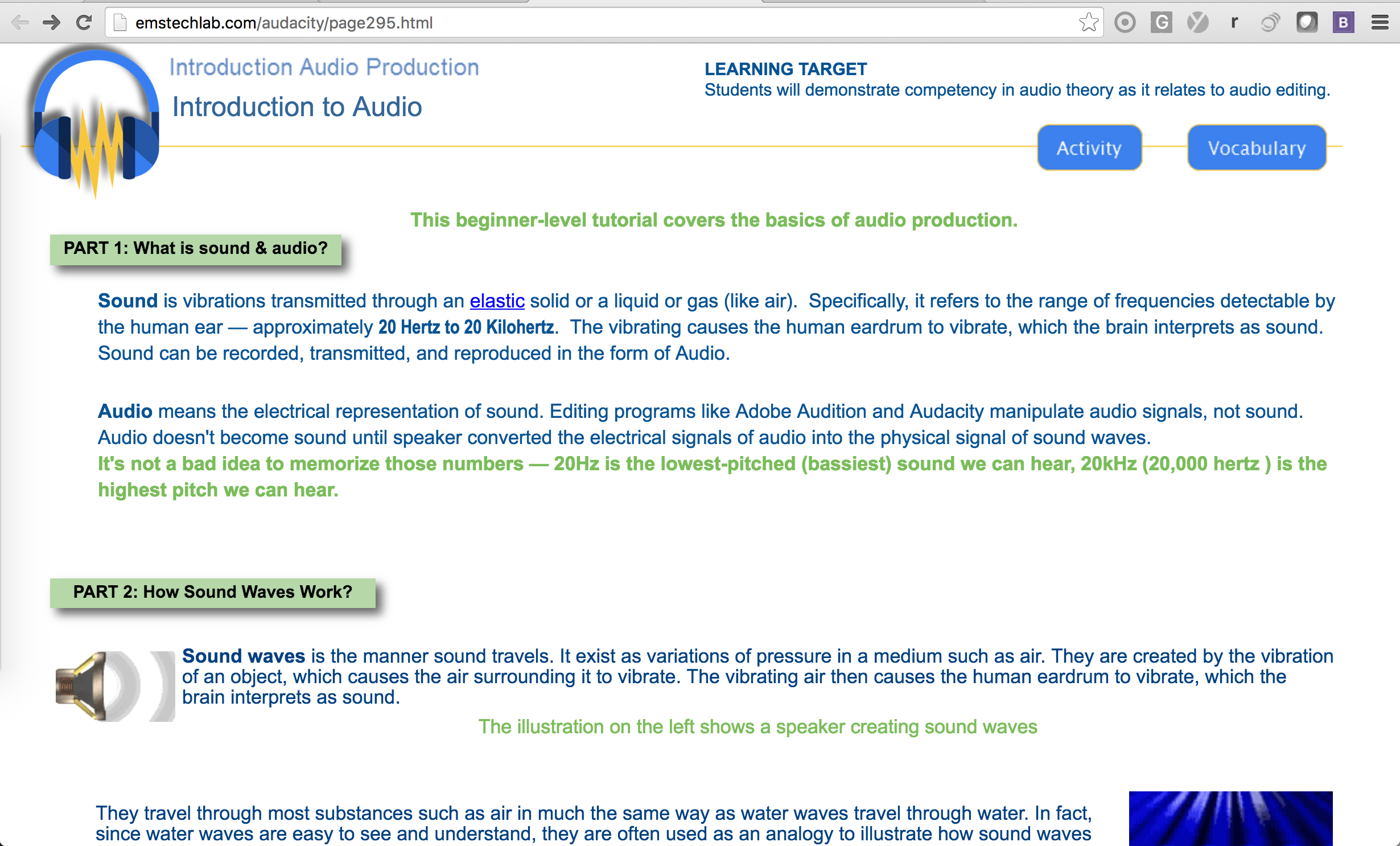

After I FTP my Lectora site and view it in Google Chrome, instead of the site I get one word in the browser, "undefined" or "undefined" plus some of the text from the webpage. If I refresh the site is fine.

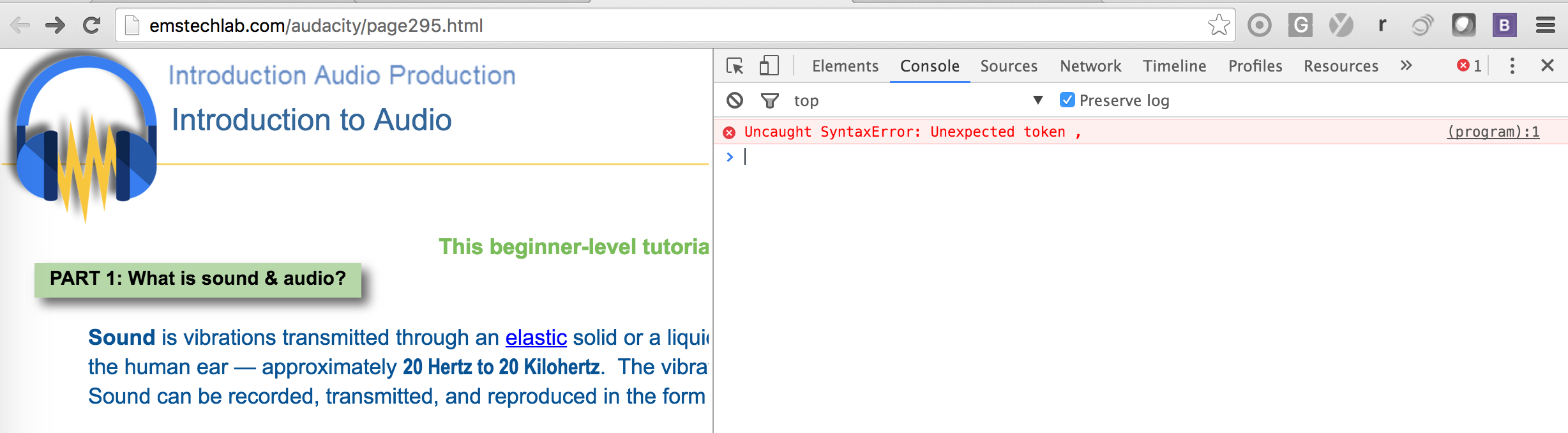

I just tested it and it works fine for me (Chrome 49.something.something). However, there was a non-critical error in the console. It seems to me that the preload function in Lectora is receiving a few empty arguments. A glitch like this could occur when moving between multiple Lectora versions. So now Lectora is trying to preload something that doesn't exist, and some servers/browsers might be pickier about that than others... Hence the inconsistent error. I'm just thinking out loud. If you share your title source with me (via private message), I'd be happy to take a look.

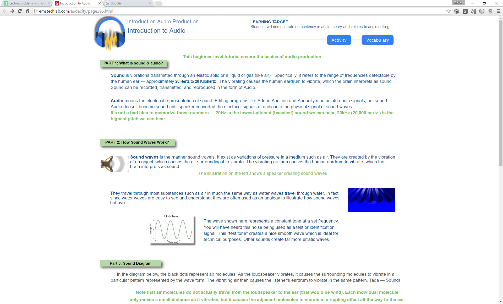

Hi, Mike. It seems to work okay in Chrome on my computer (Version 49.0.2623.87 m). A screenshot is attached.
The vocabulary quizlet worked as did the link to the activity page. The link to the definition of elastic worked and I was able to play the 1 kHz tone. The link to the waves intro also functioned correctly. I tried the Progress Check, however, the question does not get processed (I used my first name in the requester).
Since the site works for you on a screen refresh maybe you should try to clear your browser cache and try?

Here is what i see. Does this and all the computers in my lab.
http://emstechlab.com/audacity/page295.html

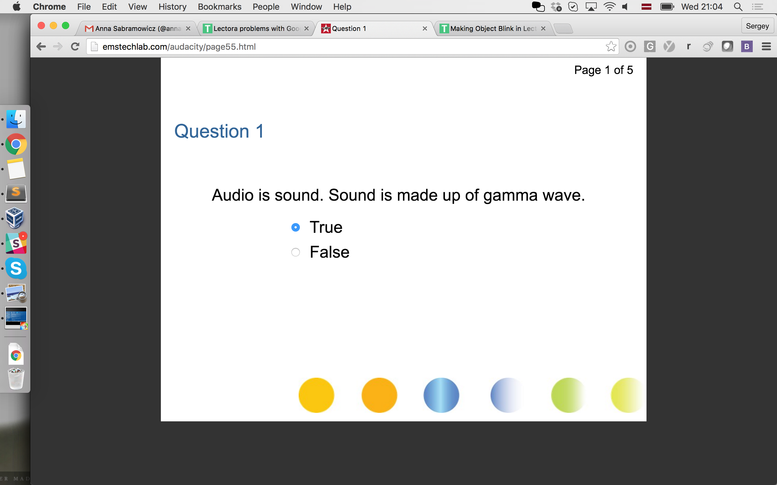

Also, Progress Check does not work for me. I can see the choices but I don't see a button to submit my answer, see screenshot.

Hi @mmacbeth4106, I looked at your files and there appears to be a little glitch in Lectora concerning preloading GIF files. @jvalley4735 should probably let the dev team know.
When you add a GIF image to the title and set it to preload, the required JS code is not generated in the HTML output. So instead of "preload(image1, imageGIF, image3)", the code is "preload(image1,,image3)" - and JavaScript does not like those sequential commas.
To fix that, simply go to GIF's properties tab and uncheck "Preload" box. Now Lectora will produce valid code. Which, hopefully, will resolve the Chrome problem you are having. Don't forget to re-publish, re-upload and clear all caches, browser-side and server-side, before you test.
