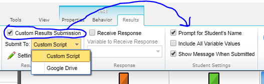

Typically if you are using a LMS you already have the student name in the AICC_Student_Name variable. The test prompts for the student's name when a Test has Custom Results Submission checked on the Results Tab of the Test Properties ribbon, and if Prompt for Student's Name is checked. (see attached screenshot)
This allows a student's name to be captured and then submitted to a custom server script or into a spreadsheet in Google Drive. The test results are not stored in cookies or local data, but they can be submitted as described, and the student name prompt is a way to capture this data for submission with the test results.
Hope this helps (and makes sense!)...
- Joe
