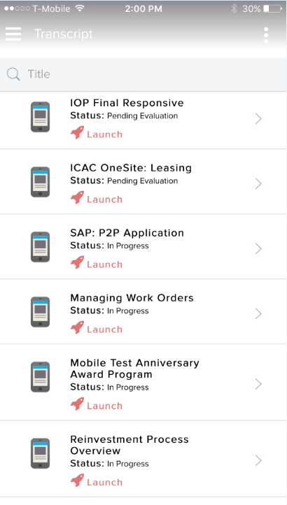

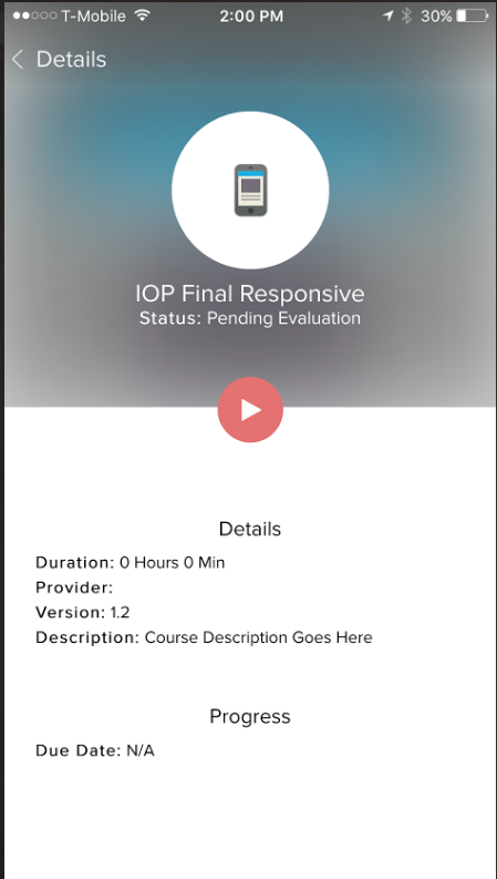

My team and I area also testing published SCORM 1.2 files from Lectora Online to Cornerstone On Demand, specifically so our learners can access learning on their iPhone or iPad.
So far I have been able to get the course status to be marked "evaluation pending" in the mobile view, but I don't think users can evaluate the course from the mobile Cornerstone on Demand app. They would have to access the LMS from a desktop. But that is just a guess. Maybe Cornerstone will have a mobile update release, hopefully in the near future.
I've added and set the following variables in Lectora Online to get those course to Pending Evaluation status:
  • Target: AICC_Lesson_Status
  • Type: Set Equal To:
  • Value: Completed
