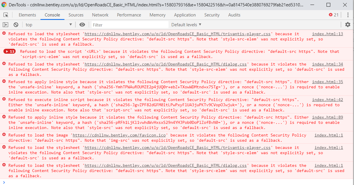

Hi,
Below assessment is not loading on Chrome/Firefox.
https://cdnllnw.bentley.com/u/p/ld/OpenRoadsCE_Basic_HTML/index.html?s=1580379316&e=1580422516&h=0a8147540e3880769279fab21ed5310a&courseID=129303&imsGuid=9afa364d-ae5e-4b12-a235-c5c2550d7399&mediaid=5018776undefined
It is unknown why the .ico file is being requested with the js and css files.
The .ico portion is what appears to be getting the error.
The CSP is preventing the main file from displaying due to this error.
Calling the js file individually loads the file but still gets the error.
Please advise.
Thanks.

It looks from your attachment as if there's an attempt to force https (rather than unencrypted http) that is failing. Maybe a certificate problem with the server involved?

No LMS is involved, we are opening it in window.open from a webpage. CSP is in place, but files are on https. But below page is not loading as it is referring to non existing 'https://cdnllnw.bentley.com/favicon.ico'.
Not sure from where the call to https://cdnllnw.bentley.com/favicon.ico is going.
https://cdnllnw.bentley.com/u/p/ld/OpenRoadsCE_Basic_HTML/index.html?s=1580379316&e=1580422516&h=0a8147540e3880769279fab21ed5310a&courseID=129303&imsGuid=9afa364d-ae5e-4b12-a235-c5c2550d7399&mediaid=5018776&env=p
Hmm ... I get the same errors in the Chrome console clicking your link. It loads in Internet Explorer 11, but with a couple of errors: "[getIMSGuid] TypeError: Unable to get property '1' of undefined or null reference"

Publishing to Limelight storage location and opening it with window.open from one of web application.
We are using Lectora v18. We haven't created any custom script or css. We have applied CSP at network level, and that is causing some issue.
I see one inline script though in all the pages like below.
Thanks.
Arnab, at this time I would either contact Trivantis Support, or upload a Zip export of your course here. There is something happening that is hard to figure out without seeing the course.
If you want to try to figure it out yourself, open the project folder in Windows Explorer, then click in the Search field at the top right of the Explorer window. Type 'favicon' and press Enter. This will search every file in the folder and its subfolders for that text. That will at least give you a hint about the cause of the problem.
