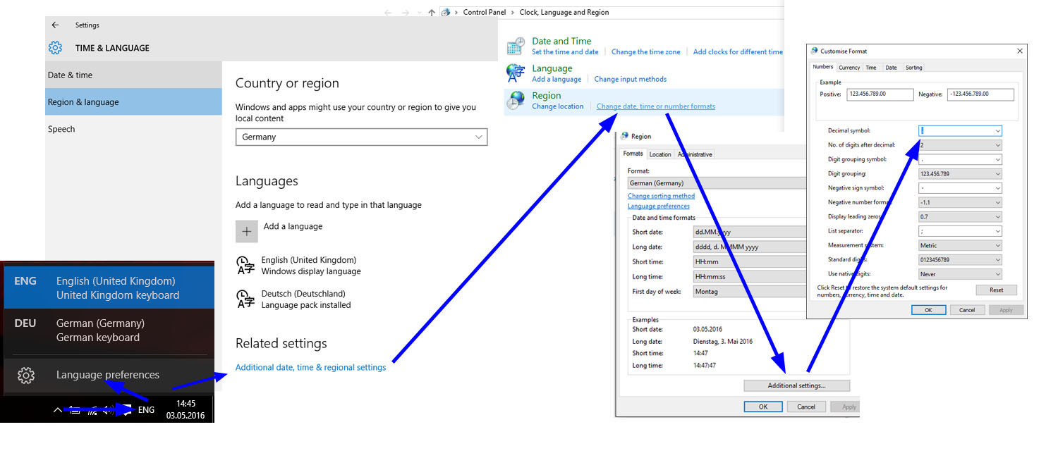

Can you tell me how to switch decimals over from commas to periods, i don't understand how to make that. Can you tell me, step by step, or with pictures to better understand. Please.
In Windows 10 (english)
Tim
