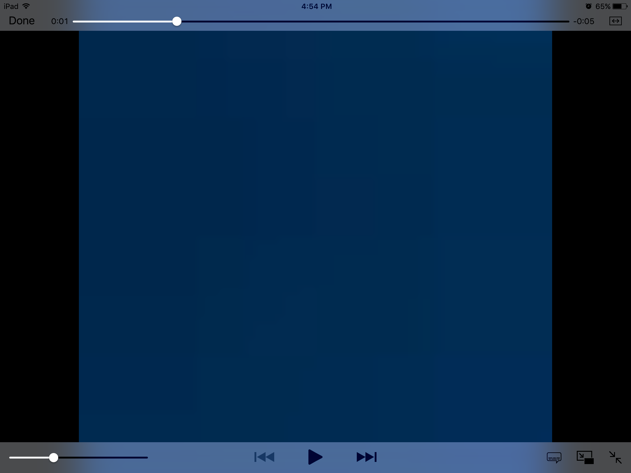

I created a responsive course in Lectora 17 (Desktop) and we uploaded it to Pilot on our Cornerstone LMS. When we tested on iPads using iOS 9, everything worked.
When we tested on iPads using iOS 10, we got a 6 second video of a blue screen (shade of the blue screen of death) on the first two slides. You have to close the videos and you can continue through the course.

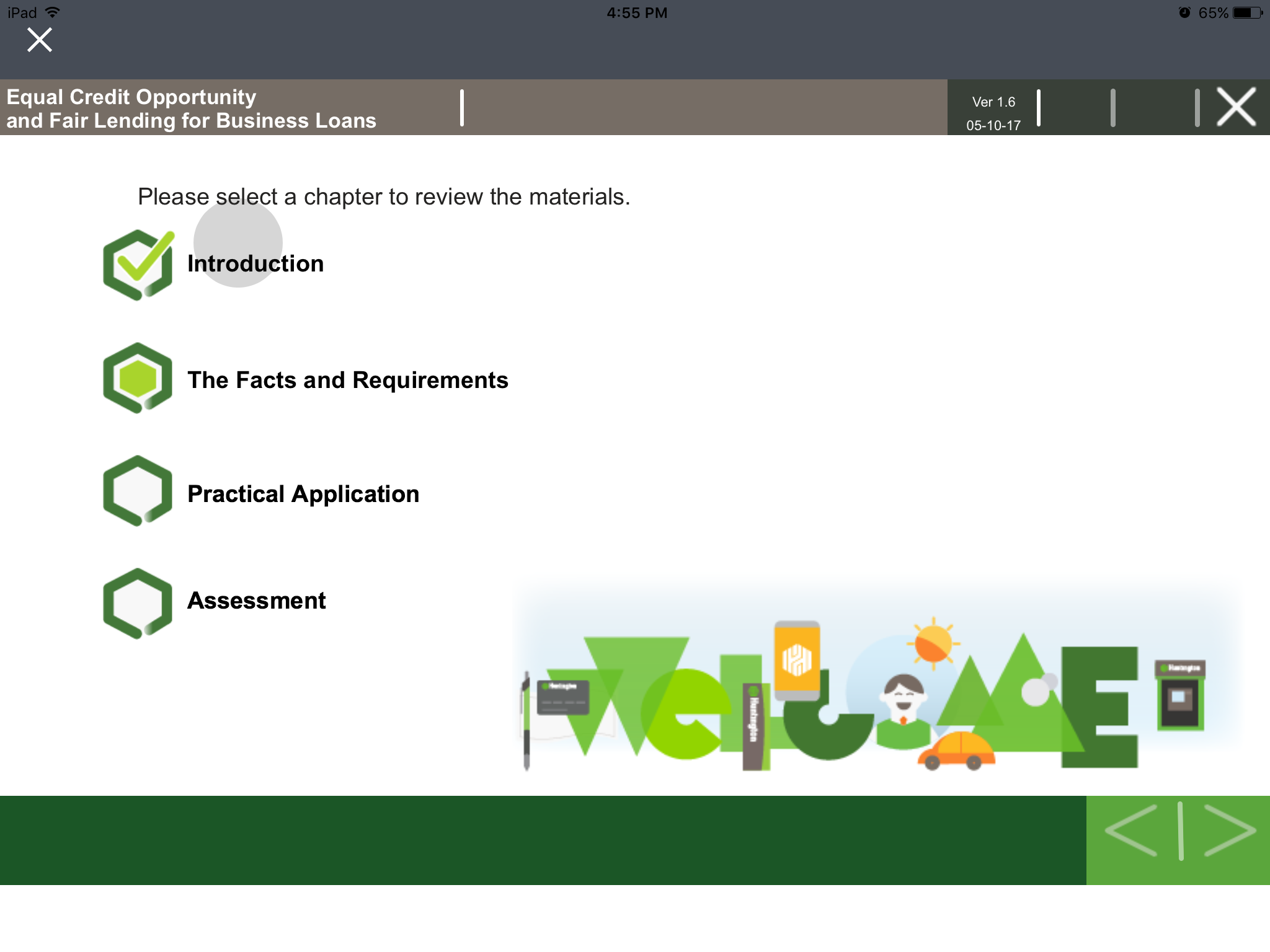

When we got to the first content screen we got a gray circle that showed up out of no where. When tapped, it refreshes the page. I checked the source. There is no hidden button anywhere on the page or at the root that would do that.
I attached pics.

I've attached screen

We solved the problem today by publishing the course with Seamless Play turned off in the SCORM publish.
I'm not sure WHY that worked, but it did solve the problem.
Thank you so much for sharing this solution! I had the same problem with the blue video appearing in the app too. I also had a random grey dot appear on all course screens too. Changing the setting fixed it.
