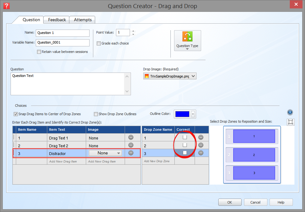

I have a customer who wants a drag and drop question where only one drag item is the correct answer when dropped on one zone. All other drag items are distractors. My problem is that when creating the question in Lectora 11.2, I cannot find where to set the distractors, so the question is always wrong. I am under the gun here and this is the only thing that is holding me up in completing this course for the customer, so any help is MOST APPRECIATED.

Hi Jill,
The good news is that whether you're on any version of Lectora 11 or Lectora 12, the Drag and Drop question will work the same.
To set a distractor, select the Drag Item on the left, and then de-select all of the "Correct" checkboxes on the right. Ultimately, you are telling Lectora that this drag item has no correct drop zones.
I hope this helps!
