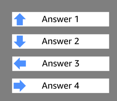

Thanks for the reply! I should have mentioned that I did try something similar to that, where an arrow key was assigned to "select" an answer, and the enter key was used to submit it (see below for UI example). This functioned just fine, but several users in testing reported being confused and wanted a simple cursor that moved when the arrow keys were pressed to select the answer.
