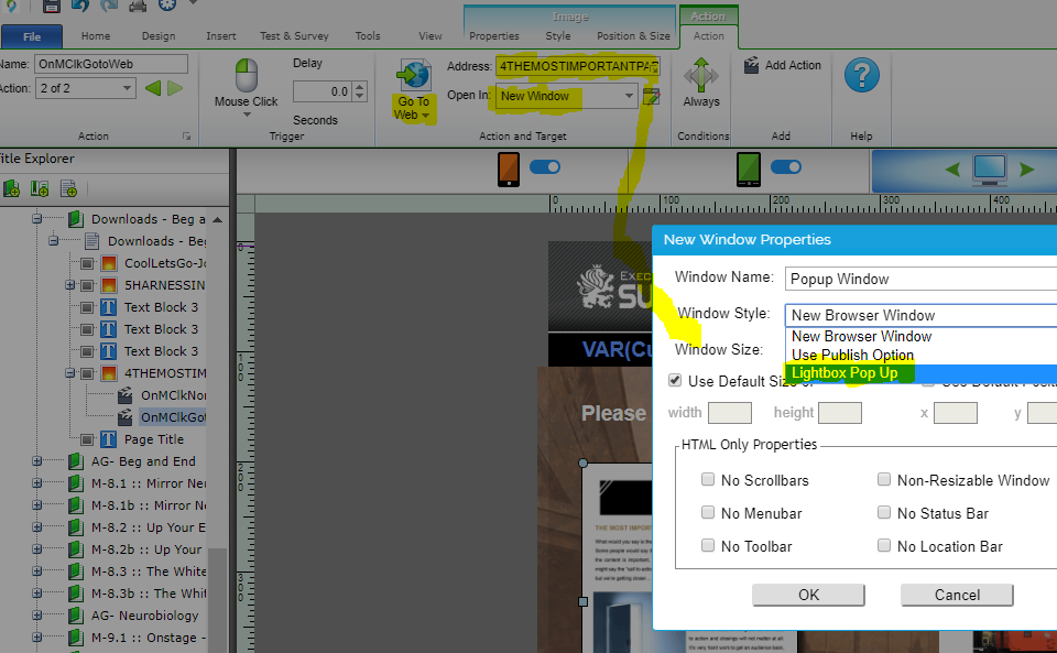

Well, I am seeing that the attachments do publish out when I publish to SCORM and then download the zip file. My guess it the actions to launch the PDFs are not working because of the modality of how the course is running inside the LMS. Maybe it is not allowing new browser windows to be launched.
You might try changing the open attachment action to a Go To Web Address action, select new window, and then make it a lightbox popup. This should at least allow the PDF to be displayed so you can know if it the PDFs are being written out in the content area. I'm attaching a screenshot showing what I mean...
