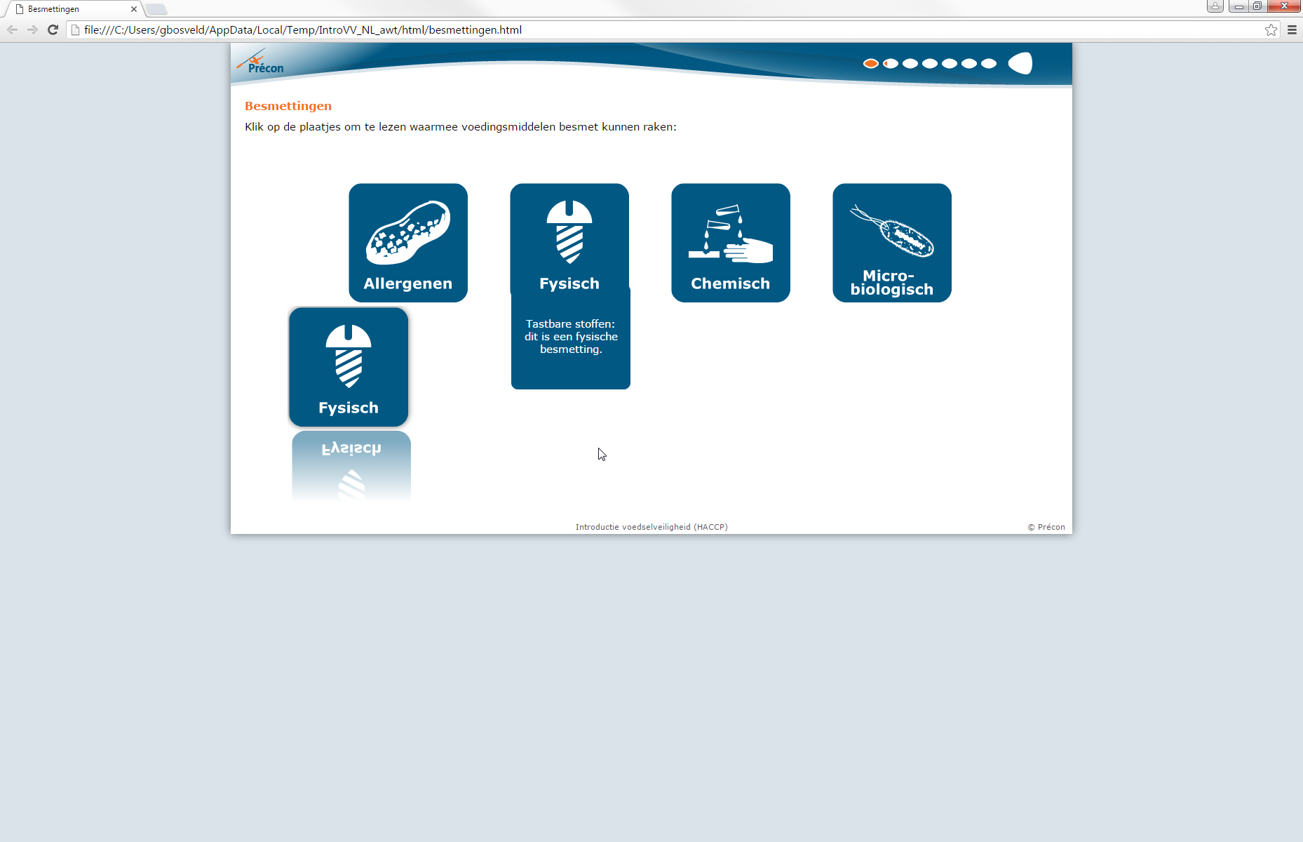

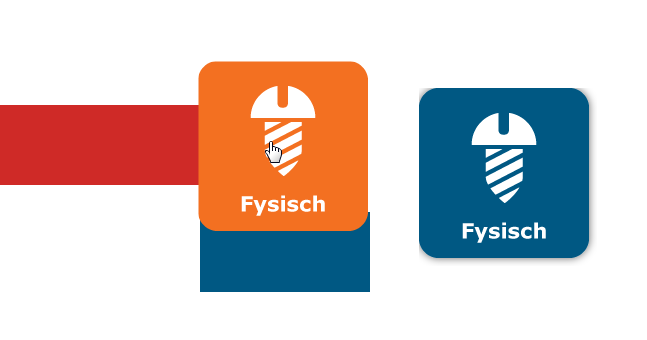

Hi there, I got some problems with image buttons:
  • The images get resized and blurry on the left side
  • They are not positioned where they are supposed to be

Yes, I want to button to have another image as rollover (white icon on blue background, rollover background is orange, if this is possible in another way will also be nice), it automatically got 4 states I see.
It's Lectora 16 and yep it's in the browser.

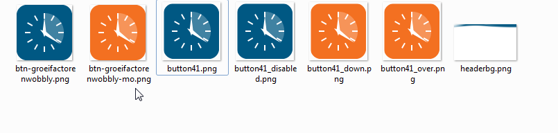

All browsers got same thing, I saw in the published images folder some new images that became bigger than the original I imported.

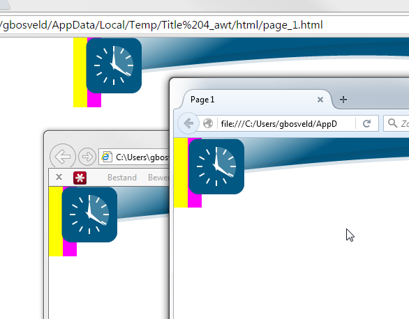

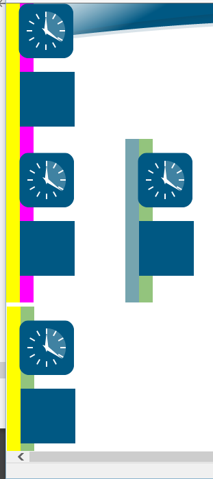

I attached my test file, the yellow box = 20px wide and the button I placed is at x=20, but as you see the published result doesn't match what I set up.
Hi George, checked your sample and did some tests. It is no bug in Lectora16.
Its an visual and optical thing partly and a screen related thing i encountered in the ancient past a lot when designing and developing for Cd-i.
The visual and optical thing is the choice of your colors. Due to contrast they give that optical illusion. If you check my image and see the copies i made...then those with more saturated colors and colors closer to the elements object look better.
The screen related problem is one i learned in the early days of multimedia ( wow, am i that old ;-)
A one pixel reposition of an image on the x-axis, can make in certain circumstances the difference.In this case the anti-aliasing of your object makes the difference..So instead of putting it on 20, you should put it on 21.
As you can see in the sample i made a change of color and/or the 1 pixel move make the difference.

One more tip for rollovers.. if the fit comes precise..as in your sample...make sure the normal image disappears when the over appears... that way if the fit isnot 100% pixelprecise..noone will see.

I do understand your confusion. Dont trust on exact numbers, trust on how it looks when published. There is quite a difference ( not only in Lectora, but in all tools alike ) between how it looks in the editors view and the endresult when published.

Well that doesn't make sense... My image is 80x80 pixels, Lectora makes it 84x84, some anti-aliasing blurs its edges (I didn't put the image on 20,5 pixel position or anything like that, just a nice, sharp, integer number) and I have to put the image on 21x to have the image start at 20x position?

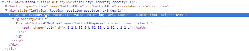

PS. if im not mistaken the SVG is only generated for the button.. as a 'invisible' click element on top. Not your images.

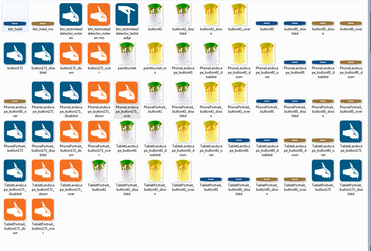

I can't fix this, it looks different in IE, Firefox, Chrome, and look, the published folder shows a different button image... I don't have the image conversion on when publishing... am I missing another setting?
Edit: As you can see, for some reason a SVG is crated, with another size than the original images and the by Lectora converted images ...

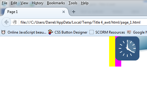

Try this. Insert an HTML Extension - Cascading style sheet with the following to your project.
button::-moz-focus-inner {
border: 0;
Darrel
The attached works in Firefox on my computer. Try it on yours and let me know.
A colleague has got the same thing, using just 3 pictures a few times, this ended up in his images folder... See attachment.

I'm pretty sure this is not an image problem. Firefox internally adds border and padding space to certain objects. Did you try my attachment because it looks perfect in Firefox and all I did to the file you provided was to add the CSS I suggested.
Hi Darrel, I applied the CSS and tested in Firefox, but it didn't work.
