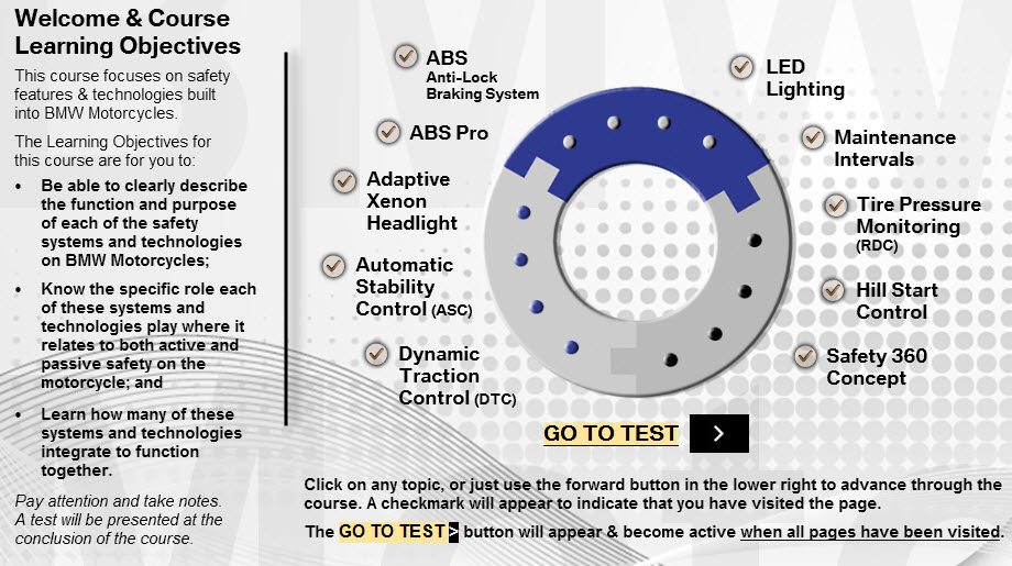

I have a course home page with introductory audio and timed text.
The page contains a wheel of menu topic items. Each topic displays a status indicator checkmark after the student has completed the page.
There's a RETURN TO HOMEPAGE button in the lower navigation panel which the student can click on if they choose not to take a linear page-to-page path through the course.
The problem I need to solve is this...
How do I stop the introductory VO audio file from playing every time the student goes back to the home page menu wheel when they want to either move to another topic, or just check to see which ones they've completed?

You need a variable to save whether the audio has been played before. Add an action to the audio
On: Done playing
Action: Modify variable
Target: Use the New variable... dialog to create a variable, initial value = 0
Type: Set equal to
Value: 1
Uncheck "Auto start" (if you've used it) and play the audio with an action on page level. Add a Condition to the action:
Only if "your_variable" "equal to" "0".
A way to synch the display of the textfields would be to use events with the audio. Click "Synch events" in the audios properties and "Set event timings" to open the audio editor and add events.
You'll need more actions on page level to show all textfields If "your_variable" equal to "1" to show the textfields when the audio is not playing.
