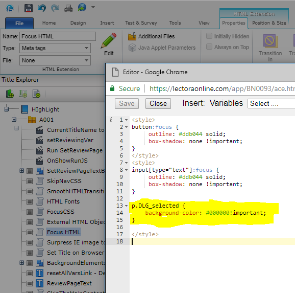

You can accomplish this with a little scripting... I will also write up an enhancement to do this in Lectora Online.
See the attached PKG file for an example of the scripting solution.
Thanks for pointing that out! My example only works for tree view TOC, you have the indented list TOC for which the change is much easier. You just need to override the style p.DLG_selected. See the attached image.

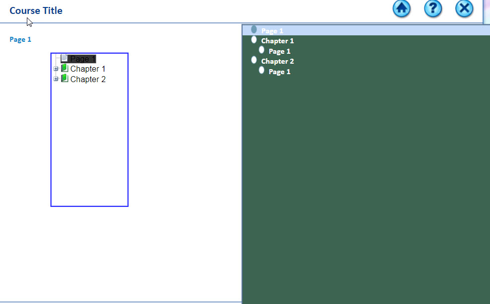

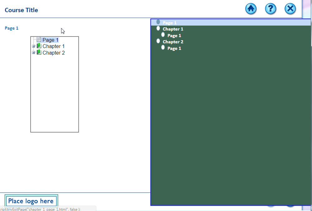

Hi Joe. Thanks for your help on this. Unfortunately, the script is not changing the highlight color in my TOC. I know the code is working because it is putting a blue border around the TOC, so it is seeing it, it's just not affecting the highlight color. (See the attachments). On the TOC in your sample the script is working correctly. I am able to change the highlight color. Is there something else I need to do the script? I've attached a sample .pkg of my template.
