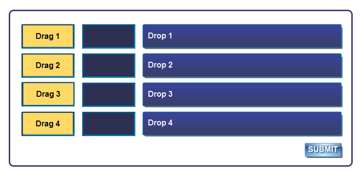

Hi, I also would like to be able to prevent more than 1 drag item to 1 drop zone, has a way been identified yet?
In the visual I attached I want the user to be able to drag 1 yellow box to any of the 4 drop zones. If a drop zone is already populated by a drag box, the drag box can only be dropped on top of the remaining 3 open drag zones.
