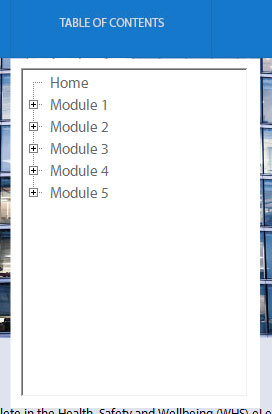

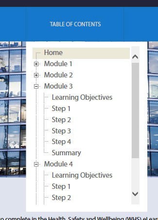

I have inserted a TOC into my title and don’t want the border as it kills my design. However, using a Frameless TOC has the items running off a background box the TOC is sitting on. (hope that makes sense!).

When I click the Preview in a browser, this all works just fine. See previewInBrowser.jpg – no border.
When I export the package to HTML, the code no longer works. See exportToHTML.jpg – bevelled border! I’ve been pulling my hair out for 2 days trying different things but I’m now at a loss…

Thanks a bunch for the speedy replies, gang. I'm coming back in here with my tail between my legs... so after an entire couple of days trying to figure this out. I finally gave up on it and uploaded it to an LMS... guess what? It worked.... omg. Why I didn't think to upload it to test, is beyond me! Stared at it too long maybe! lol
Sorry I forgot to add what browser I have been testing with... it is Internet Explorer 11 (say no more!). Why the JS wouldn't run locally is a mystery to me, maybe you gurus out there can shed some light on that!?
