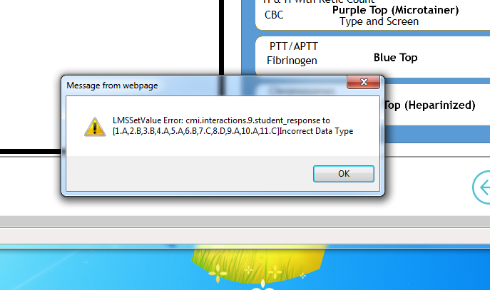

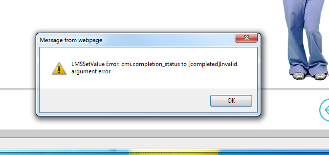

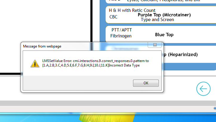

I'm having issues with Healthstream as well. I created a test with five questions. Once a learner gets to the completed page, I have three variable set up to update my information in Healthstream.
  • On page showundefined 100
  • On page showundefinedcompleted
When I publish the zip file into Heathstream and run the course, I receive three pop-up errors when I click the next button on the last test question. The next button has one action set and its to process test on mouse click. If I click ok on the errors, I'm able to go to the completion page and finish the course. Once I'm back in HealthStream, everything updates, completes, and score shows 100%
Any ideas on why I'm getting pop-up errors while I'm in the course? Attached are images of the errors.
I appreciate all and any help. Thank you!
Tim - that fixed my issues. Thank you so much for your help!
