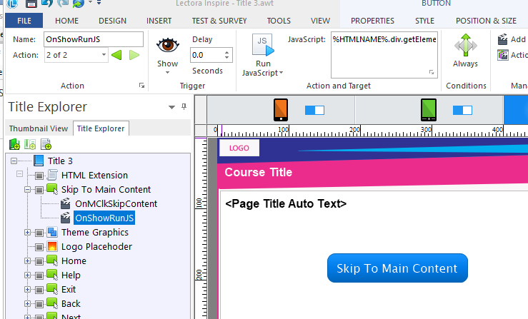

This is the way I recommend setting the focus to a button:
Use an action on the target button (Skip to Main Content):
Skip To Main Content
- Action: On Show -> Run JavaScript -> (content below)
%HTMLNAME%.div.getElementsByTagName(';button';)[0].focus();
This creates a portable (you can copy it to other titles without worrying about what the object's name or id is) action that sets the focus to the object it is attached to.

Try to remove the word javascript and the colon : from your run JavaScript action and see what happens.
