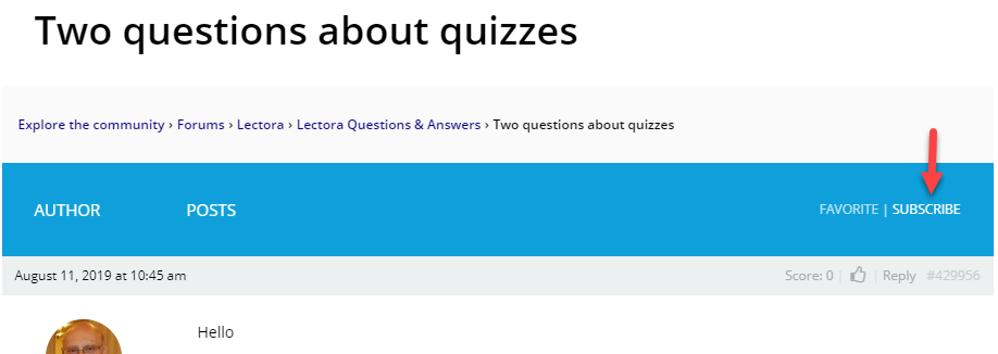

@Andrew Lian - it took me a bit to find this option as well. ; ) There is a 'subscribe' text button at the top of the conversation if you are a logged-in user.
