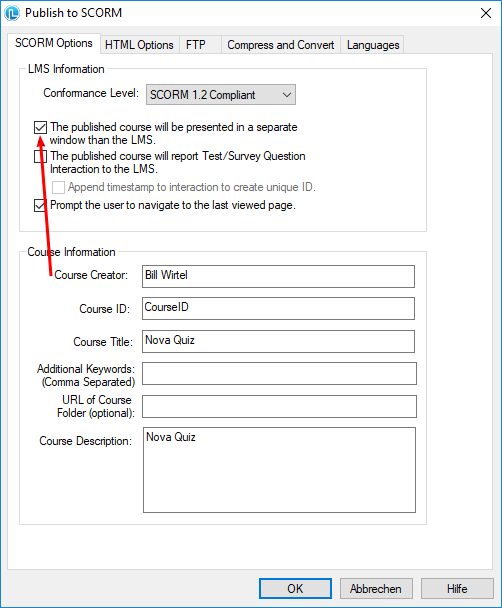

If the course opens in a new window then the settings in moodle should be the one. In Lectora you need to tell the course whether it "will be presented in a separate window than the LMS".

You need to make sure that the publishing settings in Lectora and the settings of the Scorm activity in moodle match with regards to opening the course in a new window.
It may be a bug in your Lectora version, you might consider either going down to 17.0.6 or up to the latest version 17.1.8.
CONGRATULATIONS TIM!!! You figured it out. When I published from Lectora I didn't have the open in new window checked. I did have it checked in Moodle. Mystery solved! Thank you for hanging in there with me.
