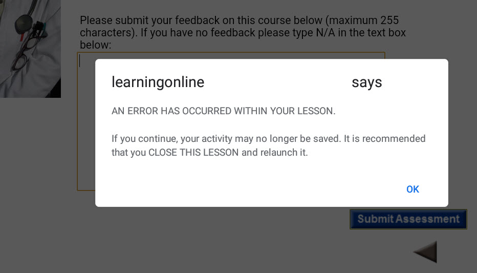

Hello. I published a course for my company using lectora version 18. When accessing the course on mobile devices such as handphone or tablets, our users get the error message as attached.
Is this something that can be resolved by checking some checkboxes during publishing?

That message comes from the LMS, I would bet. (No Lectora message would have the title "learningonline".) It's presumably some sort of incompatibility.

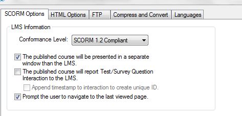

I used the publish settings as attached.
