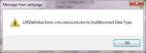

I am getting the following error message when clicking the "done" button at the end of my test when my title is uploaded to our LMS: "LMSSetValue Error: cmi.cor.score.raw to [null]Incorrect Data Type". Any idea what I'm doing wrong? I don't usually put my titles in the LMS, so I'm not familiar with this message.

Looks like you are not setting the course score to anything but your LMS needs it to be set to a number. In Lectora, try adding an action somewhere that sets the AICC_Score variable to e.g. 100.
