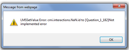

Hello,
I am facing a problem with one of the trainings recently created. After completing the quiz, users keep getting error message (please see attached screenshot). Can someone please help me in identifying root cause of the problem and how to fix it? Thank you in advance.

According to Scorm documentation you're trying to send a value to the LMS, that "is valid, but was not implemented by this LMS." Did you publish with "Report test/survey question interaction to the LMS" checked?
Lectora is trying to pass the wrong data type to the LMS. You did not supply a lot of information. Are you using Scorm 1.2? What did you name the questions? Can you post the problematic lesson or the AWT?

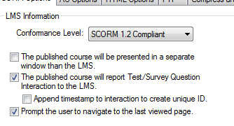

timk , yes. I had this option checked when publishing. Please see attached screenshot.

It's a corporate one called my learning. not sure if you are familiar with it? I will try publishing without this option checked. Thank You
Which LMS do you use? The error seems to be related to the course trying to pass information about the questions (the question id) but the LMS is unable to use it. Try publishing without this option.
The recording of test interactions is an optional component of SCORM 1.2 and so not all 'SCORM 1.2 compliant' LMSs will support this.
