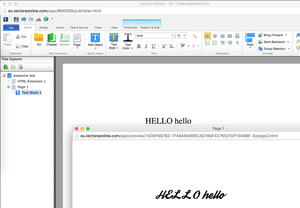

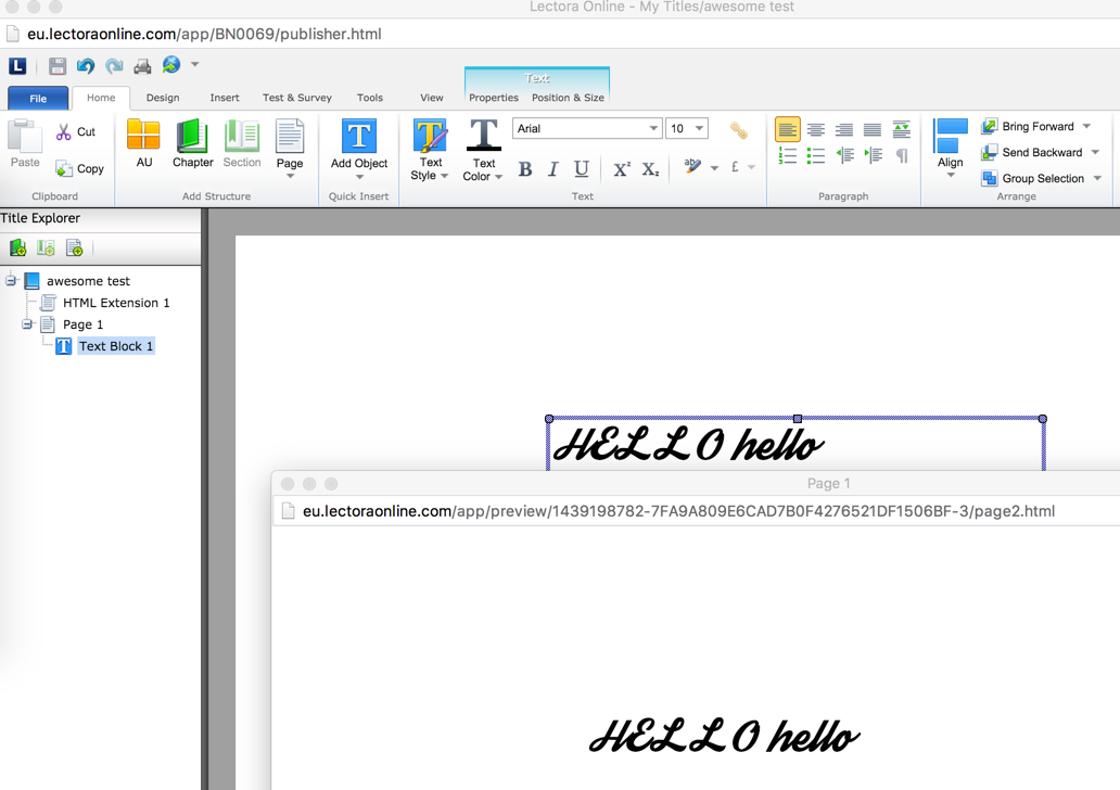

Also, I've followed the procedure carefully and this is what I got at first (see pic 1). The font wasn't visible in Edit and Preview but worked in Browser Preview. This is because it wasn't installed on my system. I installed it (right click, install, if you're on Windows or use Font Book on Mac) and it was immediately visible in Lectora as well (see pic 2).
Overall, the current system seems to work but is in the "workaround" state. I'd expect a better UX at some point, where users could add fonts on the Org level by simply uploading those in the Org Settings and specifying a couple properties like local name, family name, etc. As a result:
- Org webfonts are linked in Lectora Editor CSS and work on any machine (no need for local install.. wasn't that the point of Lectora Online)
- Org webfonts are automatically attached to Org titles (if used to style any textbox), no need to attach manually
- CSS styles for the title are automatically created, no need to add Ext HTML object and type some code in it. By the way, the sample code in Lectora Online works but isn't very robust or even commented. You'd need some CSS knowledge to repurpose it or make it work robustly on any browser.
