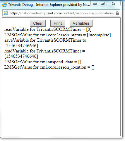

I also tried turning on the debug publishing option (all debug options were left checked). This gave me the attached pop-up with I tried to preview in the LMS. Honestly, I'm not sure it has anything to do with my issue but I've attached it just in case.

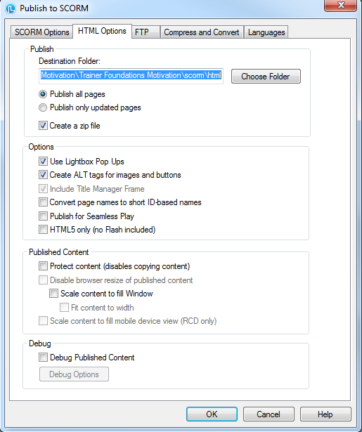

Thanks for your response Joe. I pulled up the browser debug window and didn't see any errors in the console area. Here's a screenshot of my HTML options that I'm using.
