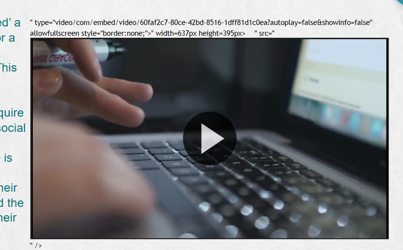

I have embedded a streaming video on a page which runs ok but in preview mode or on the LMS it shows the code used as well as the video. How can I stop this happening. I can find nothing in properties to hide this code.

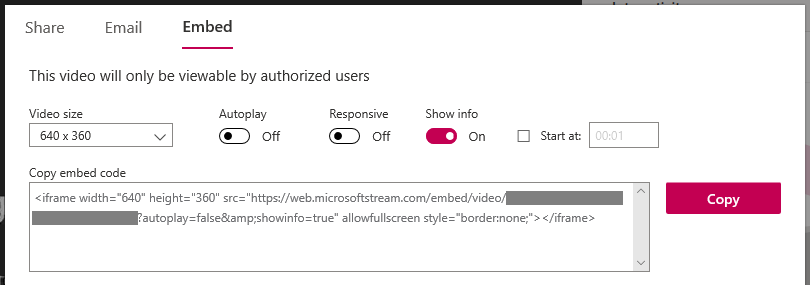

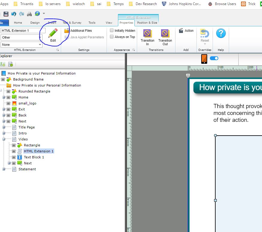

Sorry for the misinformation. Yes, you want to insert an HTML Extension and paste the embed information copied from step 3 as described in this article: https://docs.microsoft.com/en-us/stream/portal-embed-video
You can click the Edit button in the properties ribbon of the HTML Extension, then paste the embed information (see attached picture).
You will need to set the size of the HTML Extension on the position & size tab so it matches the size of the video.
Click page preview after doing this and the video should display.

Hi Joe, yes this does work, I had got that far but got confused when I opened the edit box!
Out of interest why does the code show when I went the other route of inserting a streaming video? Why does the code show?

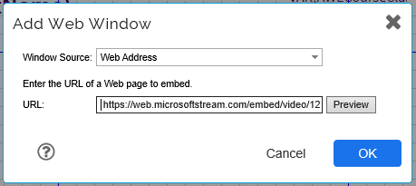

I've found that Microsoft Stream videos work best using the 'Web Window' option, and using the embed code URL given to you by Microsoft Stream. So in the below example, I'd use just the bold text in the 'Insert Web Window' tool.
