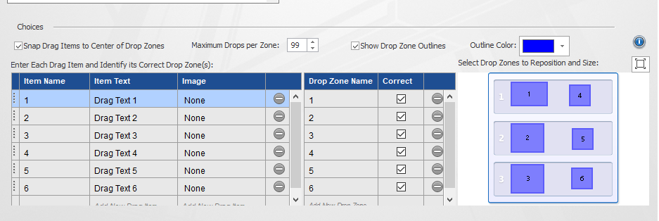

@tea attached are the question properties. All of the Drop Zones are checked on my end and that's why I can't figure out what is going on.
So you are saying in the zip package, #4 was not checked? I have noticed that the drop zones would uncheck on their own, but right now I have them all checked and no success.

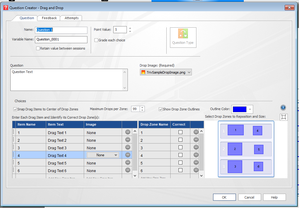

@lfowlercarter4895 I am attaching the zip and also a screen shot showing when I selected Item 4 there were no drop zones selected. When I click on the other items I do see a drop zone (or more then 1)
@lfowlercarter4895 your Item 4 does not have a checked drop zone, so your question is only looking for 5 answers. It is being treated as a distractor. Once I have it a drop zone I have to drag all 6 items before I get my feedback
