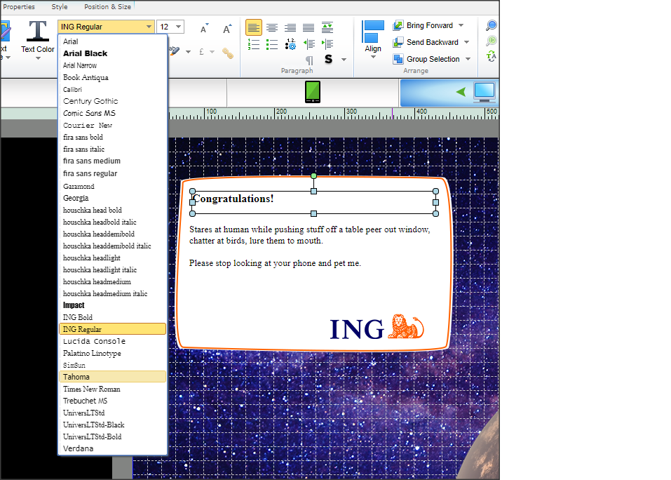

I am trying to use custom fonts again, but Lectora Online isn't displaying them at all.
I have attached an image of:

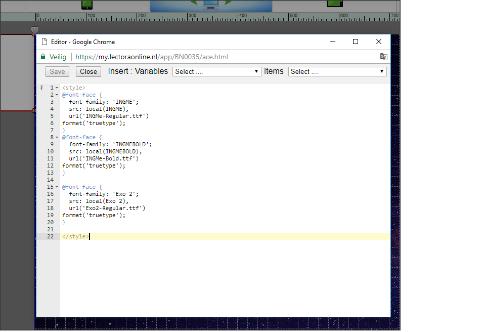

  1. The .css I use and have used before for the INGME-font (I have added the corresponding font-files in the 'Additional files')
  2. How the font is displayed in the drop down

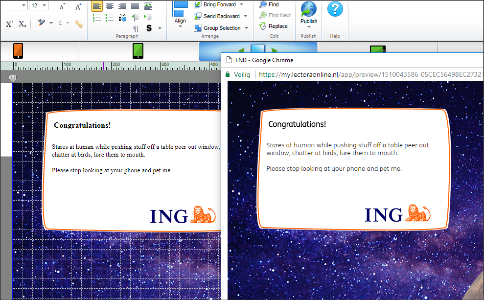

  3. How the font shows up (and is supposed to look like) in 'Page Preview' mode
The INGME font works. The Exo-font doesn't (as you can see, it doesn't show up at all). And I have no clue why.
Also: the INGME-font has about 5 more variations that also refuse to show up in the font-dropdown.

Hi Indra,
The fonts defined in font-face sections (image 1) do not seem to match up with the font listing drop down (image 2). The text for font-family (in font-face) should appear in the drop down in the UI. So in this case (given image 1) I would expect to see "INGME", "INGMEBOLD" and "Exo 2" in the drop down list. If you can provide a sample title, I can take a look.
You no longer have to install the fonts in the computer OS. They are all self-contained in the title's HTML Extension object.
For the variations of fonts, you will have to define each variation as a font-face.

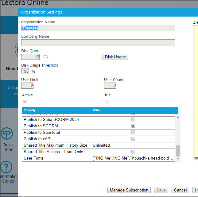

However, I'm afraid you're not correct with regards to the 'Organization Settings'.
I've been troubleshooting all day and tried many different options. But the ONLY way to get custom fonts to be displayed in the font drop-down menu is by adding them in the 'Organization Settings' first.

  2. I removed ALL HTML-extensions from ALL courses in my entire Lectora Online library (still the fonts showed up in the drop-down)
  3. I removed the User Fonts from the Organisation Settings (no custom fonts were displayed, despite there being HTML extensions)
  4. I've tried renaming the ING Me Bold font with FontForge, giving it an entirely different font-family name (added this to the Org. Settings first, then HTML and then both, and still nothing)

You will need to make a couple of changes to the HTML Extension:
  • Name: Lectora Custom Fonts
  • Type: Meta Tags
You can also look at the online help by searching "custom fonts".
You don't need to set the Org setting "User Fonts" any more; that's the old way. Using that, like you said, depends on the fonts the user has installed on their computer. So it's kind of hit or miss. HTML Ext. way is much better.
One other enhancement you can make (I think addresses your last point) is that, by using the font-face text below you can have just one entry in the font drop down list, "ING Me", and use Lectora Online's Bold and Italic buttons in the ribbon menu.
Notice all 3 font-family have the same name. Also, local is not used.
Hope it helps.
Don't forget to save, close and re-open the title to refresh the font list.

So... I figured it out.
You need to name the HTML-extension exactly 'Lectora Custom Fonts' and have its type set to 'Meta Tags'.

The culprit? Single quotes... I was so sure that I had tried all variations in the CSS... How wrong was I? :D
