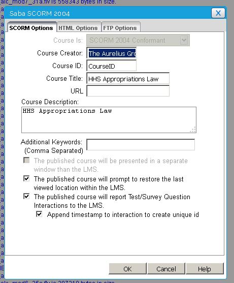

Hello Sergey,
I am building a course for a customer who runs Saba. I can't upload to Saba, because they won't give me access. I export a zip file and they test. The Saba admin tells me that the course I built does not bookmark. When I publish to Saba Scorm 2004, I check the box "the published course will prompt to restore the last viewed location within the LMS" - see attachment.
Is there something else I should to get bookmarking to work? They want bookmarking to work at the page level. Should I try that JS script you were talking about? Could you send it?
