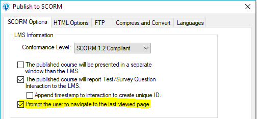

I was wondering if we can add a custom bookmark in Lectora that will allow a user to go back to the last page that they viewed. I am currently stuck with the bookmark that comes with our LMS. I want to use a custom bookmark so the display is similar to the course layout.

Thanks Cam. But do you know if there is a way to modify that? Create a different message/popup in Lectora and have it show?
When publishing to SCORM, there's an option to 'Prompt the user to navigate to the last viewed page' - this should do it (see attached screenshot)
You can change the message via FileundefinedPublish Strings
