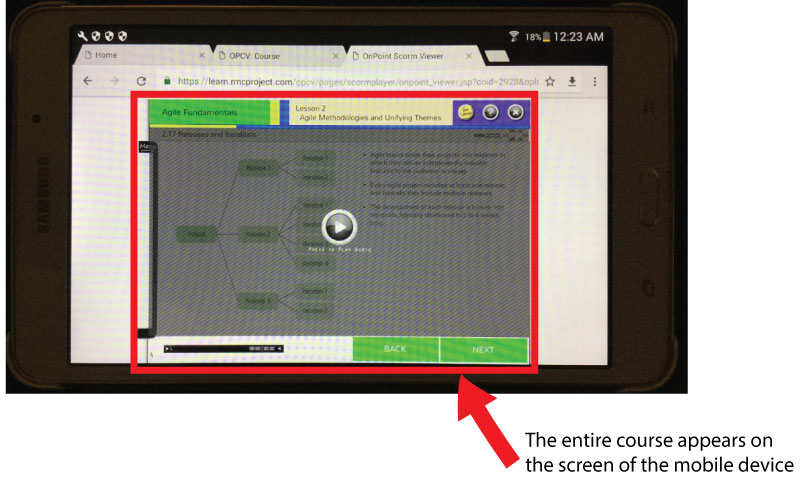

See the attachment titled pic1. This is a picture of one of our titles (named Agile Fundamentals) that was published with the prior version of LO (before 4.0) as it currently appears in our LMS (on a Samsung Galaxy Tablet in Landscape orientation).
You can see that there is extra space on the sides of the title (because the content is scaling to adjust to the height of the device in landscape mode.

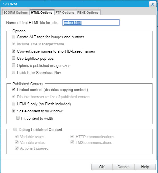

The publish settings used are shown in the attachment titled "Publish Settings".
Again, that’s an existing course that was published prior to LO 4.0.

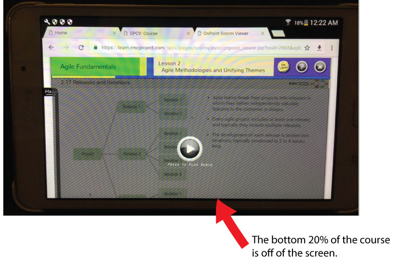

Now see the attachment titled pic2. I just now published the same title with the same publishing settings and uploaded it to the same LMS, and viewed in on the same Samsung tablet - and this is what it looks like.
I guess I was wrong in my post and the Seamless Play setting has nothing to do with the issue we are having. But hopefully you can see that something changed with the new LO 4.0 that is causing our courses to scale differently now on tablets. I know you say that those settings should not affect mobile views, but those settings did (in the prior LO version) affect mobile views the same way they affected desktop views. We’d really like to be able to have them working the way they used to.
