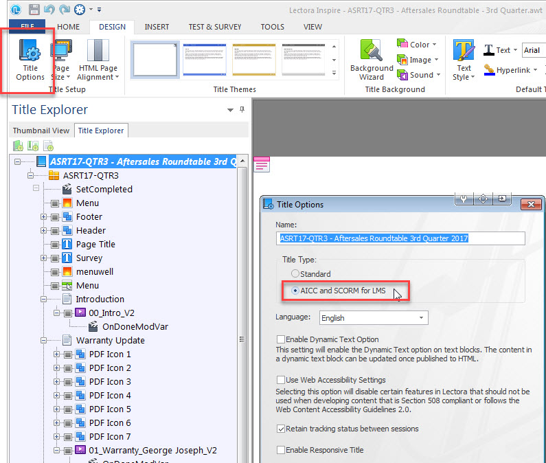

Hi there. If you don't see that variable maybe you don't have the course set up as SCORM?
Obviously, as usually, the simplest answer is the best answer. I was so sure, that the title is defaultly set to "SCORM", that I didn't even check. Thank you very much! I'll see if it works now.
