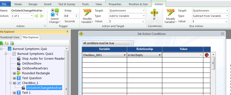

Easy. Just make the actions conditional:
IF [Checkbox_00x IS NOT EMPTY] THEN [add 1 to QuizAnswers] ELSE [subtract 1 from QuizAnswers].
See attached screenshot for how it looks in Lectora. You will have to do it for every checkbox you have.
P.S. You might wonder why the condition says "add 1 if not empty", shouldn't it be the other way round? The trick is, when you click a checkbox, it is marked as "not empty" first and Lectora fires all associated actions later. So by the time Lectora checks the box state, it is not empty.
