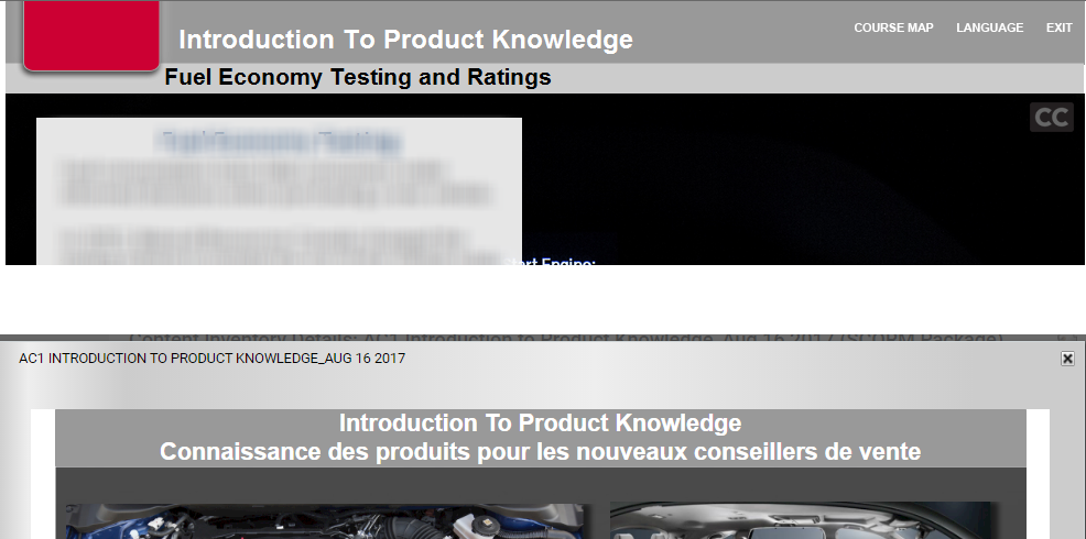

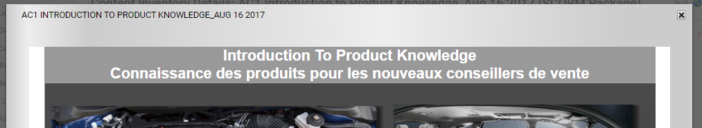

There is a title thats popping up after we publish and upload to our LMS on the top left side of the course. See image(AC1 Introduction...). How do I change this title?

Im not :( I just spoke with another person from their support team. I advised them that I did not create the bar that goes around the course that has the title and X box - they said that Lectora would not have created this box with the title and X box, and that perhaps it was created by my LMS. Would you know if this was true? I want to make sure that it was not created by Lectora before I go to the client with this information.
The top part of the image is what the top of the course looks like within Lectora. This is how it should look. The bottom image is what it looks like on our LMS.

It's not uncommon that the LMS displays the course in a frame. In your case the frame seems to be too small, as parts of the page are missing? Of course I cannot officially confirm that the title comes from the LMS, but if it's not in your title where else could it come from? This is definitely not something Lectora adds automatically. Also, this title seems to be outside the frame in that the course is displayed, i.e. in a part of the page the course can't influence (unless you've integrated scripts to do it).
In moodle you can decide in the settings of the Scorm activity whether or not to display the course title in the moodle window. Maybe there's something similar in your LMS?
